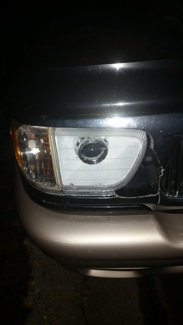

So I bought myself some clear lens headlights for my mountaineer, and then I bought some morimoto mini hid projectors.
I was getting sick of the spyder headlighta that didnt even fit.
so minutes after receiving the clear lenses and projectors I had to cut a few pieces off of the clear lens assembly and after I baked it and removed the lens it was very simple to cut and trim what I needed to get the projector to fit I I would say that the whole thing took me about an hour oh and I forgot I used a can of spray paint to make it so that the reflectors don't reflect at all / very little.
I only had time to do 1 of the projectos and one projector was missing some hardware so im waiting for that too.
pics below. .. IGNORE THE Gril I cut it for the spyder headlights.
