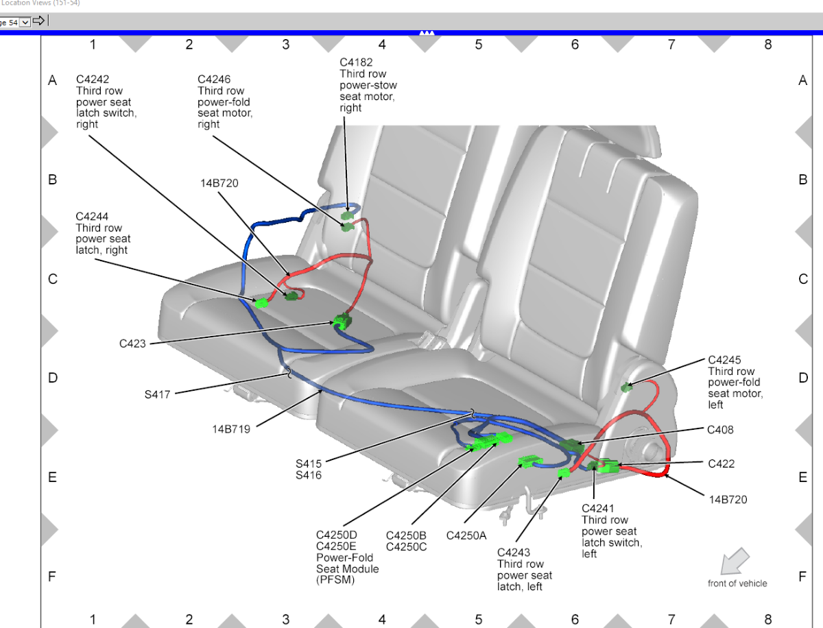

I need a wiring diagram for the third row power seat on a 2013 Explorer limited. 8 wires have been pulled out of a connector under the driver side of the third row seat causing the seat to not go into the fold or stow position.
1. What is the month/year of manufacture of your Explorer? There were early and late production versions of the 3rd row seating electrical circuits.
2. How many wires was the connector capable of holding? Was it an 8-pin shell and all were pulled out or does it have more wires and only 8 were pulled?
3. Is in an in-line connector or is it one of those that plug into the module?
Based on the diagram below, are you able to identify the connector number? There appears to be 5 connectors under there, none of which have only 8 wires.

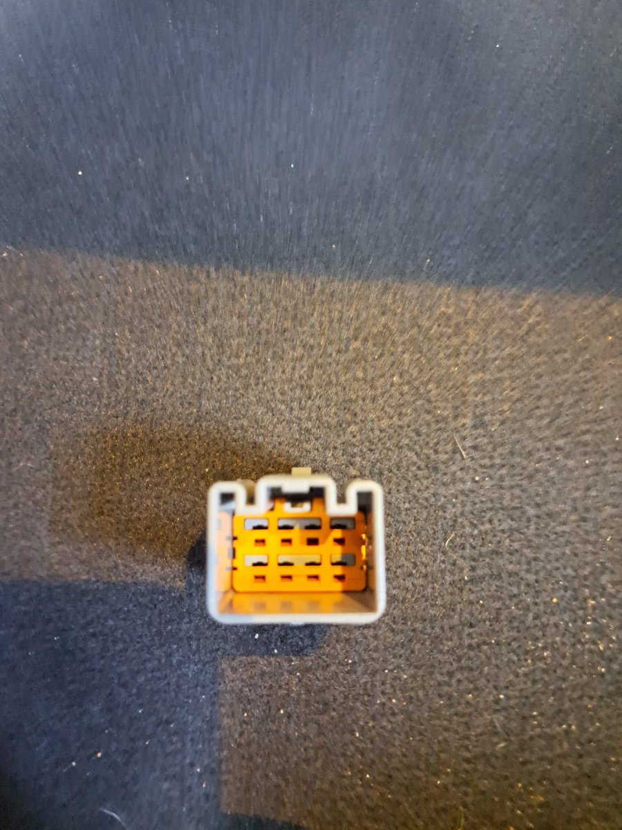

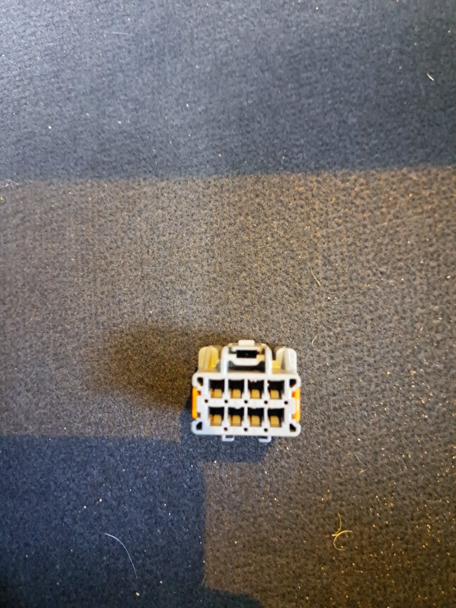

Here are some pictures of the wires and connector.
It's an in-line connector.

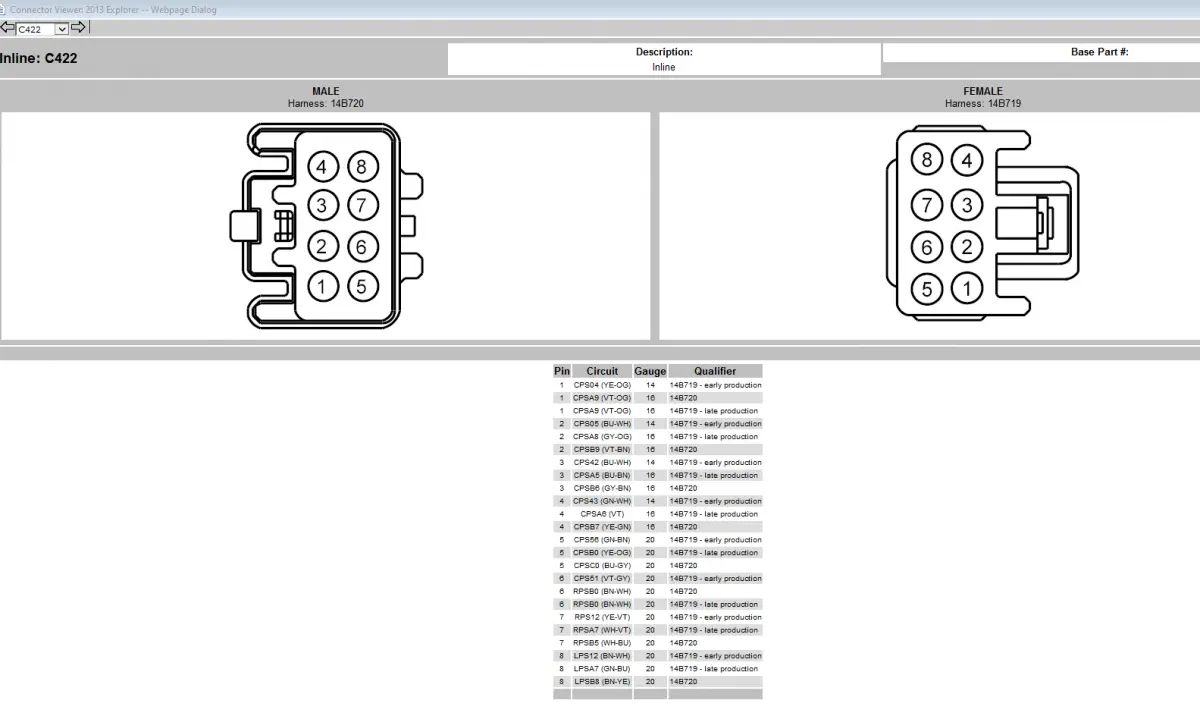

I'd hazard a guess that that is designated as C422 in the Ford documentation and that production date is probably "early" rather than "late production. No idea when the switchover may have occurred. The pinout of C422 is below. You'll have to filter the early/late info manually.
That was what I needed. Thanks for the help.
