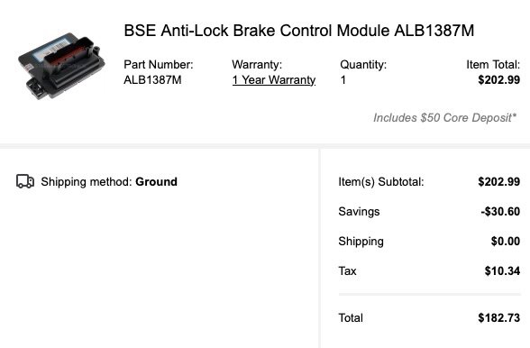

Well, I HAVE A RESOLUTION! The Monty is way overdue for state inspection. I feared my mechanic would see the ABS light and he'd throw a new control unit at it to see if that fixed it. I'm guessing that'd cost me $400 or if he did it, so I ordered one. AutoZone seemed cheapest, at about $180 (with some discount) and a $50 core coming off that. So $130 net. I installed it, and I've not seen the ABS light, after the start-up test, come on since. I do greatly appreciate all the help, and especially the offer of a known good controller, but I thought that should go to someone more in need than I. Now I'm going to work on engine oil leaks, starting with the valve covers. I'll do the intake gaskets, too. I have a new passenger side exhaust manifold on the parts pyramid, so I'll fit that and a new EGR valve and tube. That'll save me the trouble of having to try to unscrew the old one.
Thanks again! I sure learned a lot about reading wiring diagrams!
