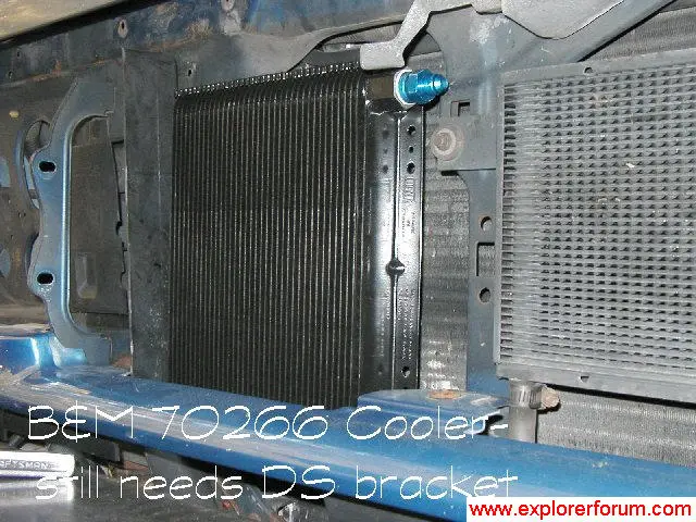

Heres a shot of my B&M cooler. You dont need to use the AN fittings, but this style plate type cooler is much better than a tube and fin. Stock cooler is on the right, aftermarket on the left.
Install took a couple hours- I removed the grill, and fabbed up new brackets. The hoses just run from the tube out of the rad to new cooler, and then from new cooler to tube back to transmission.
