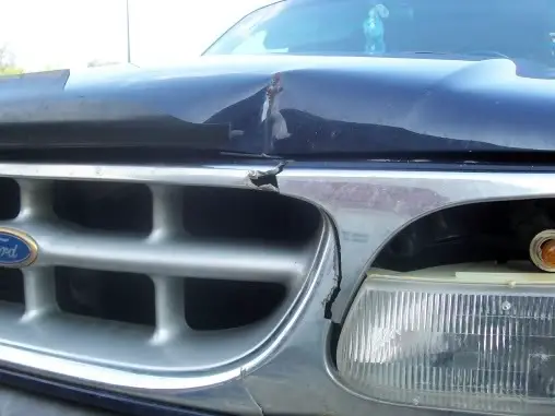

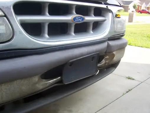

These pictures are of my '97 Ex. The Wife totaled a brick mail box. My brother and I are going to attempt the repair and would appreciate any advice, suggestions, tricks, etc. that you can offer.

easy! New hood, grill bumper, lights! OUCH
How far back does the damage go is the first thing to check out, then you will know more

hahahaha holy crap, no seriously you need to look behind the grill etc to see if the header panel was damaged, geesh.
Hoods, grills, and bumpers are not as expensive as you may think and would be the prefferred method to fix this damage, you may be able to pull that out of the hood, but the grill and bumper? beyond repair....

The damage is pretty much surface. The radiator and TA cooler are not damaged. There is a slight flare-out of the front fenders. Also, the front end was knocked out of alignment from the accident, but I don't know if there is any suspension damage. It drives fine, but the steering wheel was knocked off center.
Ron
Am I correct in assuming that the thin painted piece below the grill is part of the header panel? If so, then I definitely need a header panel.
Ron
yes it is
I kept my eye on craigslist.org when I needed these parts, I ended up with a complete nose from a 97 Merc for $300, both fenders, hood, headlights, header panel, grill, bumper, hardware, mounting brackets, hood shocks and struts, etc....for $300
just needs paint.

410 forgot to mention you will need a header panel as well.
