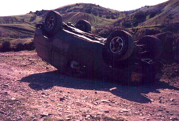

well, dont go flying around the parking lot.... and if all you did was bend your bumper... you didnt wreck your truck... this is a wrecked truck
oh, and Xplorerkid, your hardly one to talk ;)
PS:: u might want to edit it and correct the spelling even tho i mispell almsot everything i had a lil trouble makin out wut u were sayin but i finally figured it out
see i said dont flame :D and i even said that i dont spell right half the time and i told him that i hope things worked out so i didnt make fun of him
i learned my lesson last time i made fun of some one COUGH i got a thread started COUGH:D
EDIT :: ahh yes the famous picture of jims rolled truck hehe
