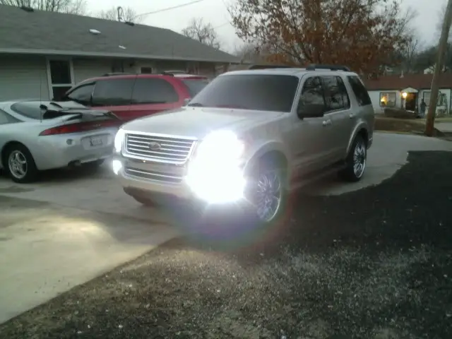

Kudos for retrofitting, I simply haven't had time/gotten around to it. Eventually I will but for now i aimed them down a bit to not bother oncoming drivers, and since day one I have never been flashed. Also I been running 55w for about a year now and no bubbles in my Chrome, I think I'm safe by now.

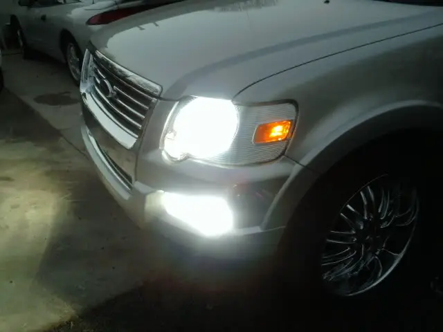

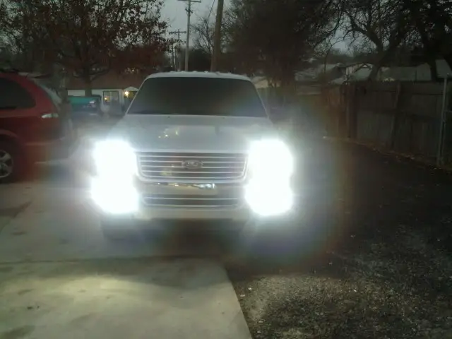

My hids from retro-solutions

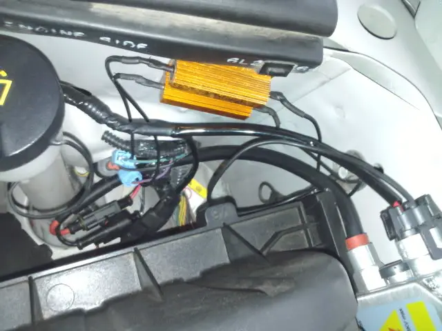

I just installed hi/lo hids on my 2006 ex. It went in perfect no light out on dash or pulsing on high beams. It was all plug and play. Check out my posting for pics of the beam and install pics. You don't need projectors for a 2006+ ex.

They look clean I got the 4300k.
The only other option outside of running resistors for the high and low beam would be to run the direct plug in bi xenon HID's. I work for and run an HID shop here in Georgia so i'm quite well vested in the solutions. I myself have a 2008 Trac that i've had for a few months and it took me a bit to figure out the problem mainly because my dad has the same bulb size in the top of the line expedition and I did a 55 watt kit in his truck hi/low and got absolutely no error codes. I've got an aftermarket conversion in my 2006 Acura TL with 55 watt ballast on D2 bulbs since the stock system died.
The before mentioned solutions are the only two I've found that worked. Some customers mentioned removing fuses but I have to remind them that the sensors dont work like DRL's, you cant just pull a fuse and fix the issue.
where did you bought your hid kit for headlight and fog lights?? also where did you bought the resistors, for you explorer???
Look up ddmtuning.com they have everything you need h13 bulb size and 6 ohm 50 watt rist.

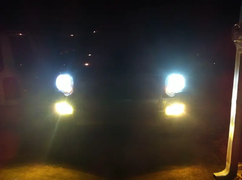

Shots of my HID setup, 6000K Bi-Xenon Headlights, 3000K Foglights, both are 55W AC kits. My lights have been re-aimed properly and I have never been flashed by an oncoming car. Lights have been in my truck for a year now, no problems. I also have had the same kit in my 2001 Explorer Sport 55W headlights and foglights since 2007 with no problems.<p>
<br>
<br><p> The only time i was every flashed in my 2001 Sport was when a shop working on my steering rack somehow broke the adjuster on my foglight and I didnt notice until that night how high it was pointing up.
