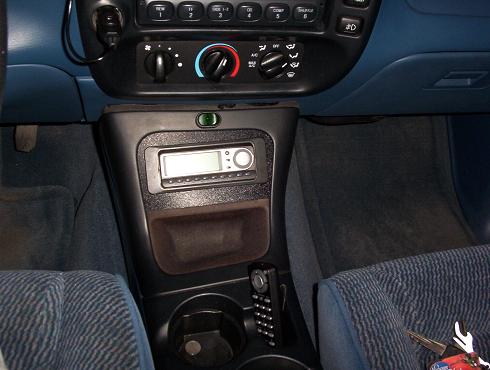

my idea when i made my mount, was to hide it when i was in high crime areas, and have the unit at my fingertips....this is what i came up with

mine

Matt, that is what I have been thinkin about. I really like that, did you install it yourself? Also, if you know, what is used to go around the radio to seal it up?
That looks great.
That's not a Roady, though. The XM Commander (Terk) seems to have the dimensions to go into a dash. It's really made for in-dash installs. Make sure to keep room for your power/antenna and audio cables with the Roady, If the Roady2 is like the original Roady, they call plug in on the side.
Yeah, but Ive been looking at prices, and that is not but only about 40 or 50 dollars more. So that one could be it. Also, its true that the Roady 2 wires do plug into the sides, so I might go with the Commander.

i took a piece of abs plastic and just cut a hole in it, and mounted in on that. if you take out that center console pocket thingy, the pockets unscrew out, and just cut the abs to fit in bewteen the pocket and actual "rim" type thing and just sandwiched it in there. i hope that wasnt too confusing. matt
It looks great, and I love that idea. I hate to copy you, but I might. Just one more question, where did you get the plastic from? Maybe Lowes or somethin?
i just went down to the local car audio shop, (NOT bestbuy or circuitcity)...it i came in a 1x1 foot section for like 5 or 6 bucks, good luck and let me know how it turns out
Alright, thanks
Matt I know you're headunit is XM ready (I have the exact same one). Was there a reason you didn't go with an XM tuner to plug into the IP-bus on your Pioneer? Just curious as to what your reasons were for going with what you did.

B/c on the display (on the pioneer) you only get 8 letters. On the commander to get 2 16 letter lines. Plus it was already mounted and it was easier just to get an adapter because i still like to the XM's faceplate mounted where it is.
