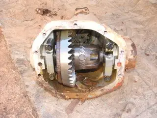

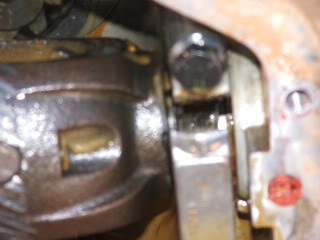

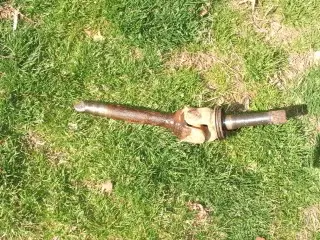

I'm only running 35's. what happened was I welded my front gears (worked well for a little bit) Then put Jeep locking hubs on. I really pushed it hard to try to climb a big rock to no success because one of rear tires wasn't spining (Ijust rebuilt the damn rear too!) So I kinda let it have it 1 last time and broke the axle, forced the carrier bearing to break the bearing cap, AND broke the hub the carrier bearing is pressed on to. Oh yeah, I also cracked the case. ;>

I've thought about going solid for years now, just happen to have the frontend of a Bronc available. Looks like for now I'll just get another D35 and put a locker in it sence my gearbox has started leaking because of it. Too bad I can't put a stonger chunk in it's place without changing the whole suspenssion. Maybe one day I'll come across a solid axle for a five-finger-discount. Have any links to a how to?
