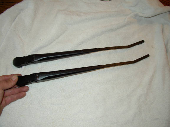

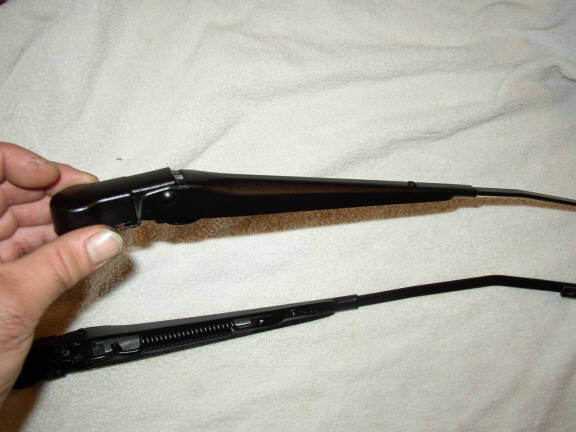

I have been practicing with my powdercoating system. So, today I thought I'd coat the wipers on my Wife's Nissan--might as well hit the ones on the Mounty also--

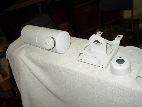

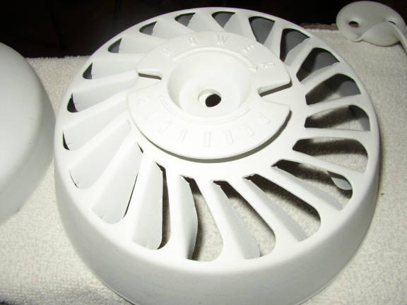

Here are some antique lawnmower parts I coated with 50 percent gloss outdoor white hybrid

very nice work. Ive always wanted a powder coating setup. But then if i had one i might get carried away.
Thanks.

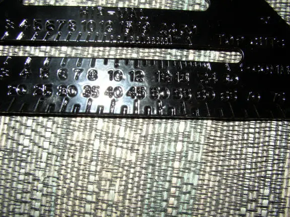

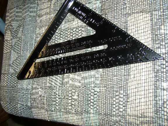

Surface prep is the key-
30 minutes of beadblasting, at least, went into each wiper arm.

O man, looks good. Like said above great detail even when it comes to the small areas such as numbers on the square, would you be able to do wheels in your current oven? If so might have to have a talk with you...
