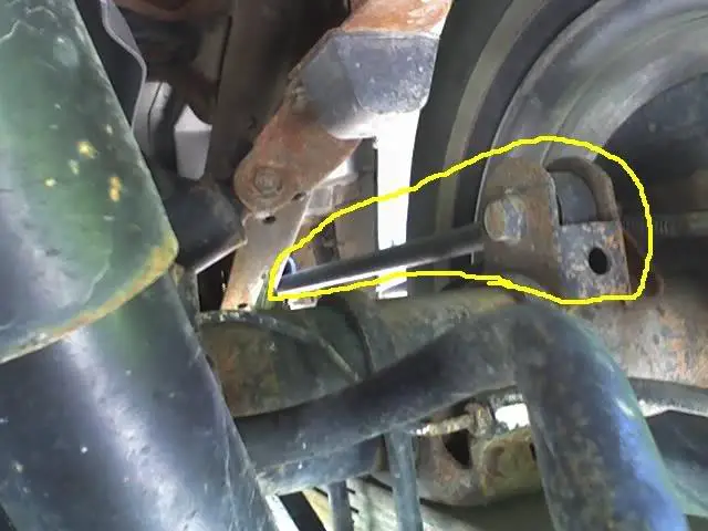

We've already run into a minor snag the rear axle I'm getting is from a v6 so it doesn't have the mounting tabs for the rear control arms, does anyone know where I can get that bracket, or run without them?

Cut the old one and reweld maybe? If not you can always fab up some brackets, shouldnt take too long.

Heck-if you need to go that far, weld in a nice track bar set up.
I don't know if my 90 amp (actually more like 70 amp) welder will cut it though.
I have seen v8 2wd without the control arms-I think it will drive fine. The leafs will hold it.
You could drive it to a welding shop to have the tabs welded on.

I guess you can run it arm-less and always come back to it later. Its not like the truck wont be drivable w/o it.

Good news on the control arm/traction bar front. Johnstone has been running a 4.10 rear from a v6 in his dd explorer without the bars and everything has been fine, he hasn't noticed any difference.

You won't need the traction bars- they didn't make any noticeable difference on mine- only limited flex, not a problem for you, but you won't notice a difference I'll bet.

If it helps any, I never ran those bars after my V8 swap and all was well. I have been thinking of adding them now since I just swapped to a 3.73 LS rear from a V8 so it has the mounts. I have all the parts, maybe I will just do it. The multi-leafs can hold the power just fine.
