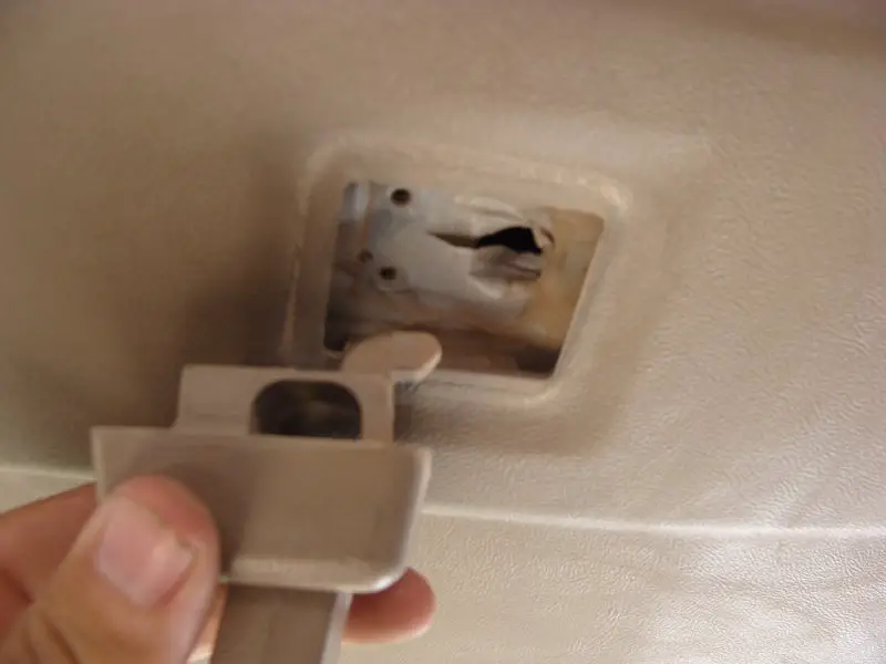

Remove the plastic trim from the rear hatch. Start by removing the pull handle (2 screws) and then remove carefully, it hooks into the hatch in addition to the 2 screws.
Next pry up the cover over the door lock with a putty knife or small flat screwdriver and remove the single screw

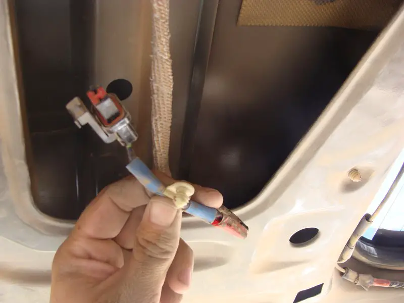

Remove the plastic push pin as seen in the picture below. This holds the wire you will need to work with. Push up on it with a screwdriver or pliers while gently pulling up from inside the hatch.
Next remove the electrical connector from the door latch, it has a single retaining hook that you need to pry up with your fingers to remove.

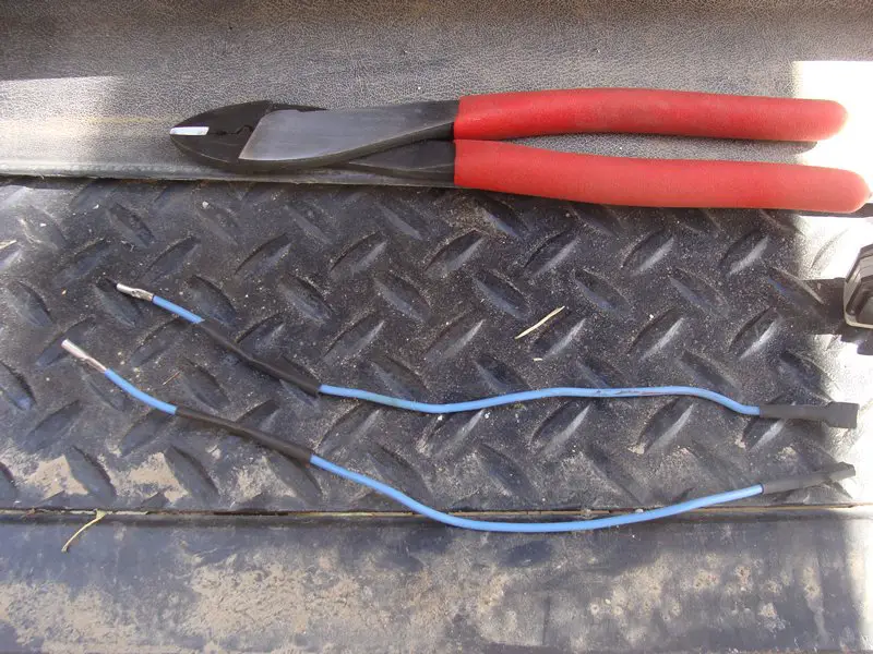

Make your harness out of 2, 10" long pieces of 16ga wire. 2 female spades for the switch end (your switch may vary) and then a butt connector on the other with heat shrink.

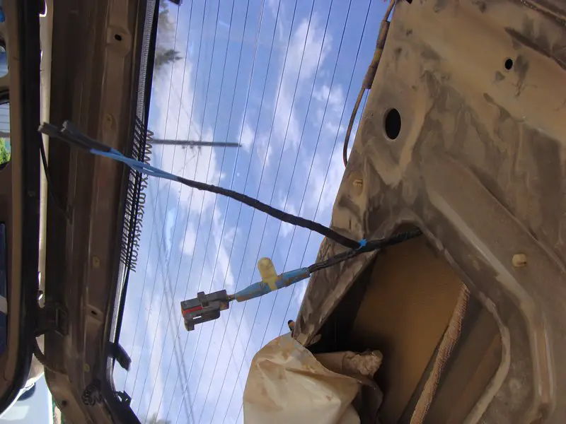

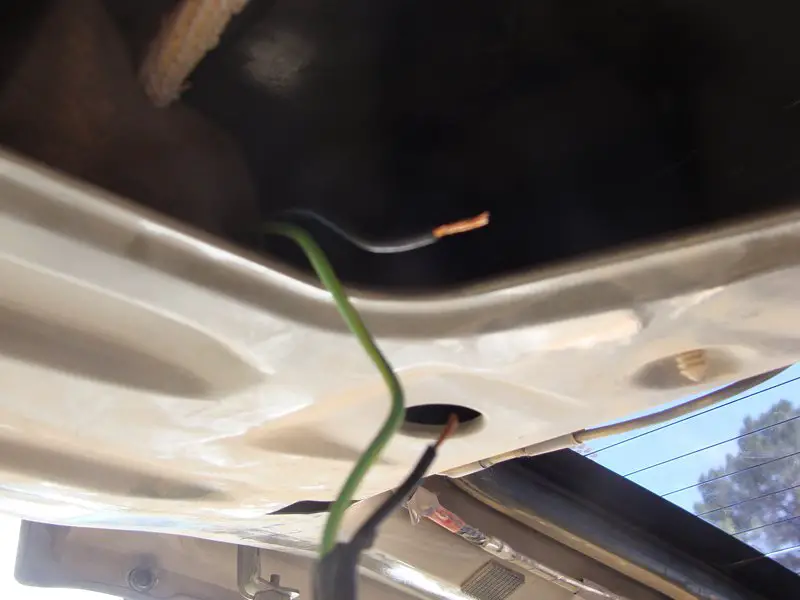

Carefully cut back the layer of tape on the stock harness and then cut and strip 1 of the wires. It does not matter which one you cut.

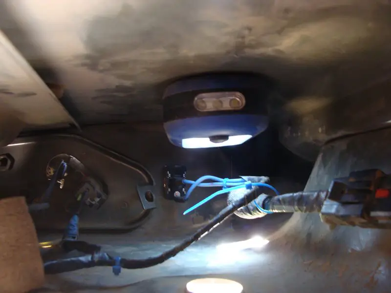

Splice in the 2, 10" pieces of wire and then re-wrap with electrical tape. I added 2 zip ties as well.
Install the switch and tighten it and then hook up the wires. Reinstall the electrical plug into the latch and then the plastic push pin into the same hole it came out of. Secure any loose wires with a zip tie. Also note in the picture below the small tab with a hole in it is the one I had to bend back.
