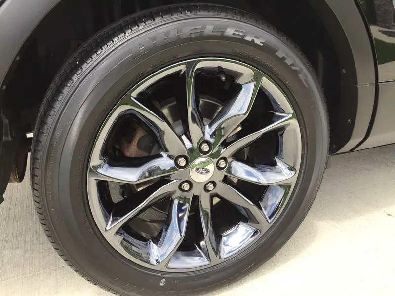

2011 Ford Explorer EX with 67k on the original Hankook tires and experiencing a wobble at 59-64mph-ish. Replaced tires with Bridgestone Alenza Plus, which were rough and noisy. Wobble in the steering wheel was also present at the same speeds with these tires. Swapped out for Bridgestone Ecopia 422's, which are very quite and mostly smooth, except at the same speeds. Still see the wobble in the steering wheel at the same speeds. Rotating any of the above tires made no difference.
The "wobble" will sometimes be there and other times it is smooth. Most noticeable on course pavement. Tires have been Road Force balanced one day after a fresh calibration to the machine. 1lbs., 10lbs, 10lbs. and 11lbs. Had new wheel bearings replaced in the back for an unrelated issue. Much quieter now. Suspension in the front is tight, or so I am told from the tire shop and dealership. I did have new rotors installed on front and rear, as well as the caliper pins greased in the front. No change.
It is a very odd situation. If the "wobble" was not occurring, you would likely not notice the vibration at all. But, take your hands off of the wheel and it dances at those speeds - very noticeable.
I'm not sure what to do next. I've had three sets of tires on and two sets of rims - all checked out fine. Road Force figures are great and the brake rotors have maybe 2k on them. Further, the wobble was present before the rotors were installed, too.
The car did have the steering recall performed by the prior owner, but I don't think the rack was replaced. Just the update to the computer.
Any thoughts?
