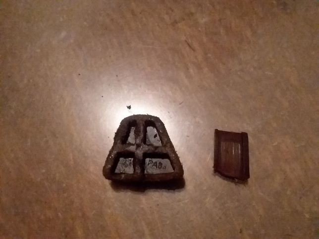

I finally pulled the valve cover back off for possible use in my '02, and found these
The larger piece is about 1 3/4 x 1 1/2", and was wedged in the top corner of the head riding on the timing chain. It had ground the reinforcing ribs in the top corner of the valve cover down to almost nothing. The front cassette is gone. The chain could probably be taken off the sprocket as is. Fortunately, the engine was at a low idle when it quit, so it's probably a good candidate for rebuilding - for another truck. I won't rebuild it for this truck because the rest of the truck needs too much work. The floor pan is rusty, as is 1 door, and the rockers, and there's play in the steering. I'd still have a $1500 truck, even with a fresh engine.
@429CJ-3X2 Yep... She's dead. Rebuilding and swapping into a different truck is probably the best option!
I'm sorry to hear of another SOHC dying, they are great when right, a pain when not. The cost of the parts is now over $500, so the labor and tools, the time, it's hard to justify the work for the current value.

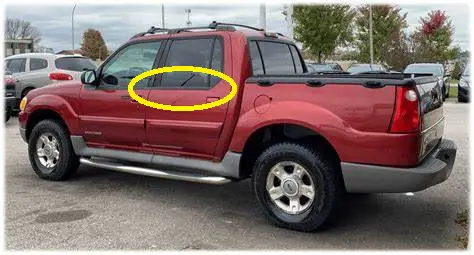

Pics would help. I can only guess that you're talking about this part here
but you might mean the one on the bed window glass. In any case, somewhat more information is required, but please provide that information in your own thread. We will happily assist you with your problems if you will respect the format of the forum.
