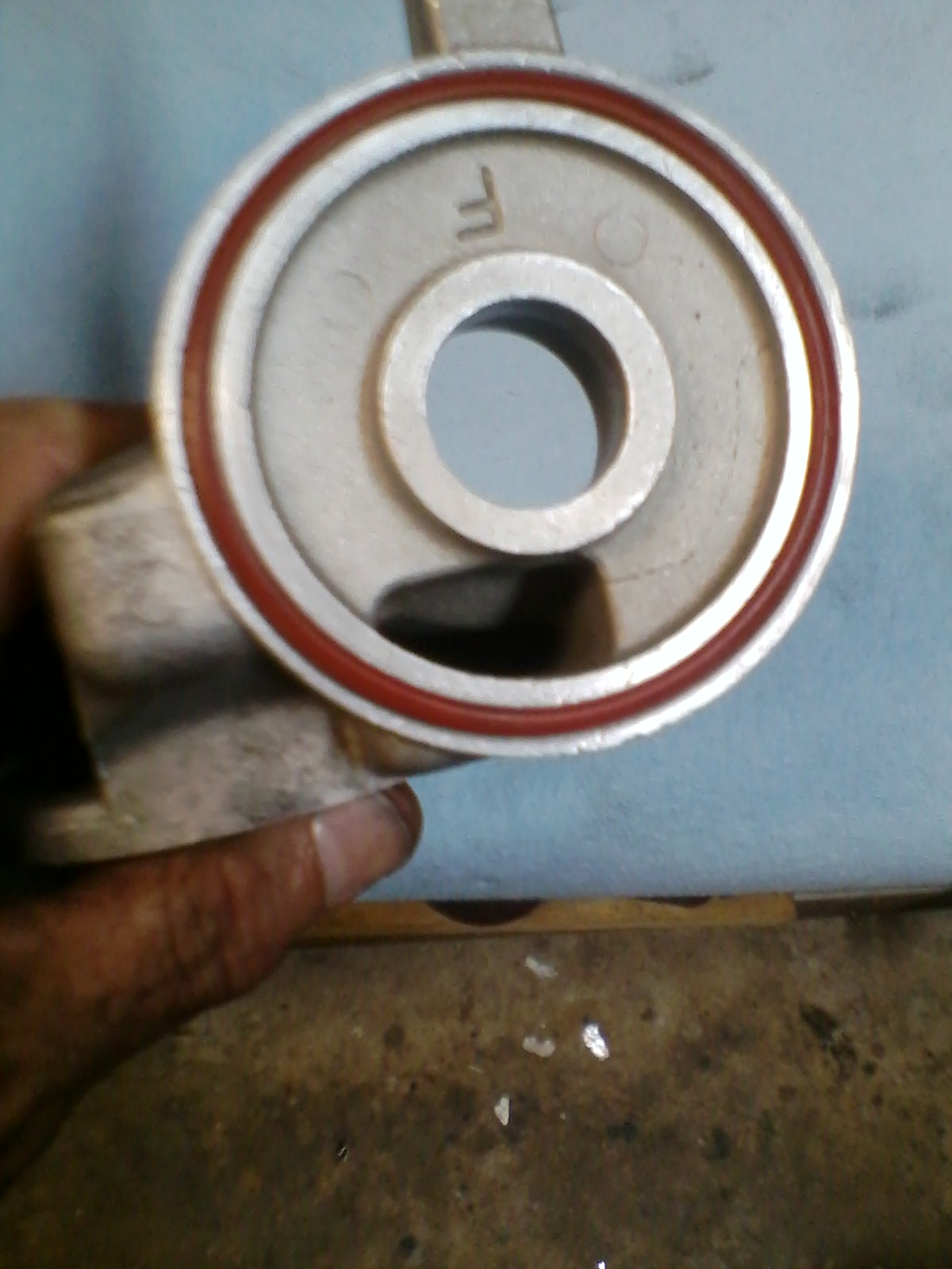

Fellows: Replacing the o-rings on the oil filter adapter in my '02 4.0l v6. The old o-ring that seals the adapter to the block was red in color and fit the square groove of the adapter just fine.

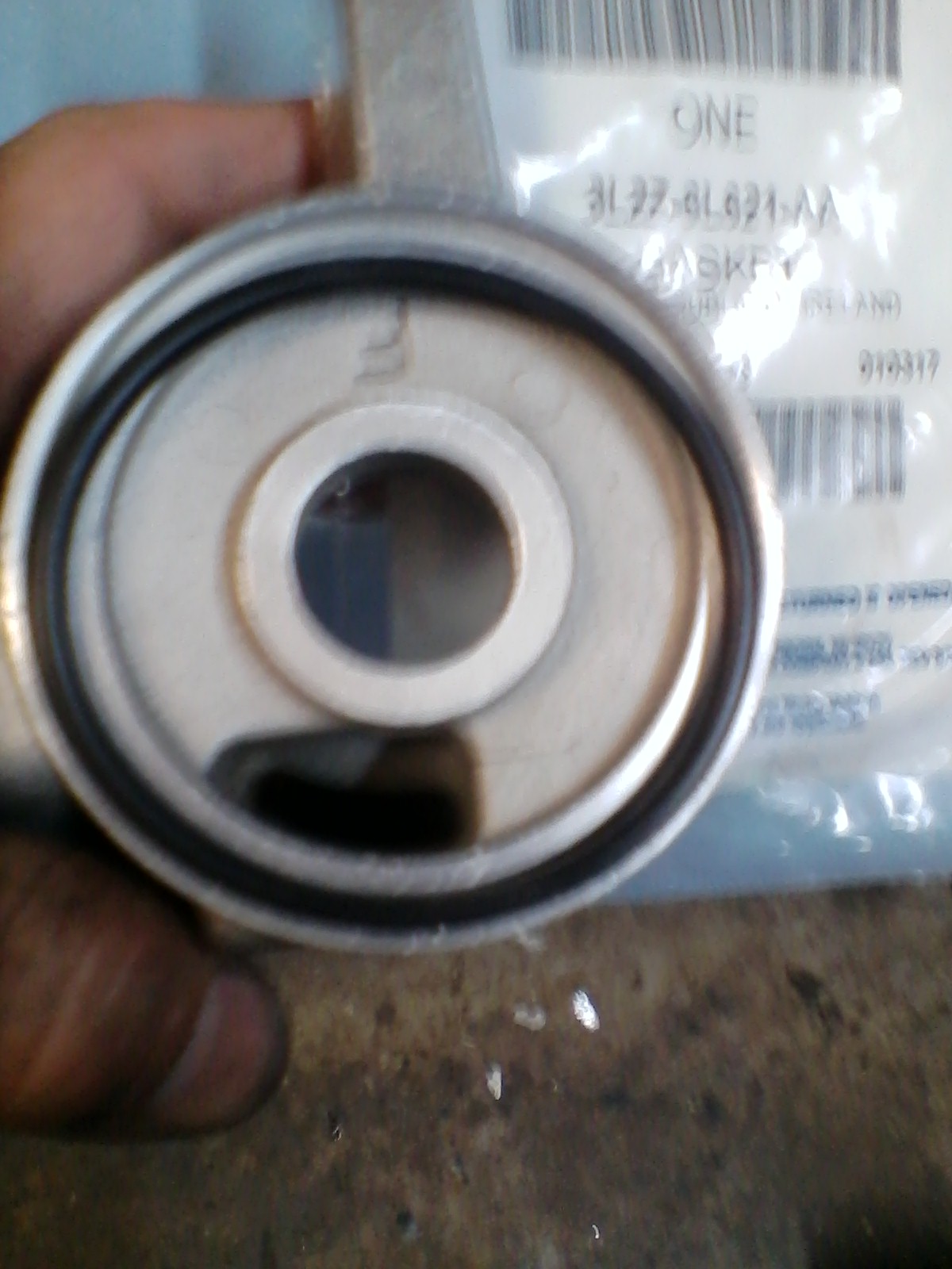

The "new" Ford o-ring is black in color, p/n 3L2Z-6L621-AA and is too small to fit the groove.

Morninig Koda2000. 26.5mm is about a inch. I have seen this same number mentioned on the 'net. I bet it references one of 2 of the o-rings that go around the bolt. I picked up a Felpro red colored o-ring p/n 72884. Fits into the adapter groove just fine although its cross-sectional diameter is .010 ish smaller than the Ford o-ring I have.
Showed the wife the 'issue" with the black Ford o-ring....... She took it and whamo-bamo rolled it right into the groove.
Being that its abit larger in cross-sectional diameter I'm wondering if I should use it.

I went with the FelPro 72884 o-ring after checking out the specs on that o-ring on the FelPro site. I measured the cross-section incorrectly (rubber and a caliper) as the FP site lists the c/s diameter as .141" which is about the same as the black Ford o-ring. This Felpro part just seemed to lay into the o-ring groove better.
