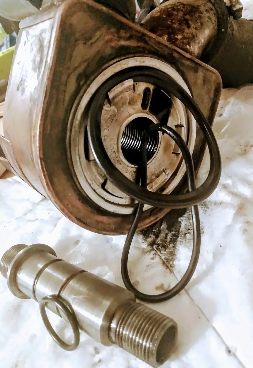

There is a 3rd one. They are call oring seals or gaskets. Kinda confusing. 2 Orings are on pot meatal that one 3/4" bolt slides in and attaches it to block. One quarter sized that bolt head seals againstMy Fel-Pro full SOHC upper and lower engine gasket kit came with the oil filter adapter o-rings. I got the kit through Summit and I think they listed the part numbers for everything included. I believe there were 3 separate O-rings for the adapter and it's bolt. The Fel-Pro number for the full kit was 2601898, maybe you can read the individual part numbers on the box..
The other is bigger that fits on same pot metaland that seals against the block .The 3rd one is on the aluminum housing that the tube/cylinder slides in . One end of tube has the hex head on it. This where an oil filter is screwed on. The other side has the larger sized oring that has a thin lip on the inner circle of o ring. This lip is tucked in behind 5 metal tabs. It seems tabs are to hold oring in place . There's your 3 seals/ oring/ gaskets
