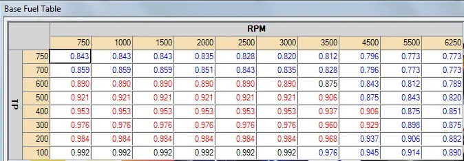

In your tune there should be a TP setting to establish WOT. When that value is exceeded the PCM multiplies the value in the Base Fuel Table for the particular TP and rpm by the WOT fuel multiplier. The stock tune for my Sport had the WOT Fuel Multiplier set to 0.875. The entry in the stock Base Fuel Table for TP > 700 and rpm > 5500 was also 0.875. That means the PCM would be commanding .875 * .875 = .765 or 11.25:1 AFR. I think Ford does that to protect the engine from detonating at WOT. I prefer to have the AFR controlled by the base fuel table even at WOT. So I set the WOT Fuel Multiplier to 1.00.
Good info, thanks for the tip.
Another thing I do is expand my table indices so the engine parameters are always within the table values. The PCM normally interpolates between two index values in a table to determine the specific value. Below is the "safe" Base Fuel Table I initially generated for my Sport when I added the M90 with the WOT fuel multiplier set to 1.00.
In the above table if the TP is 550 and RPM is 4000 the PCM will interpolate between TP = 500, RPM = 3500 and TP = 600, RPM = 4500 to get the specific commanded value. If the value exceeds an index limit the PCM can't interpolate and normally uses the closest index. However, I had crazy things happen sometimes when interpolation is not possible. That's why I increased the max RPM from 5500 to 6250 which is the stock rev limiter setting and increased max TP from 700 to 750.
