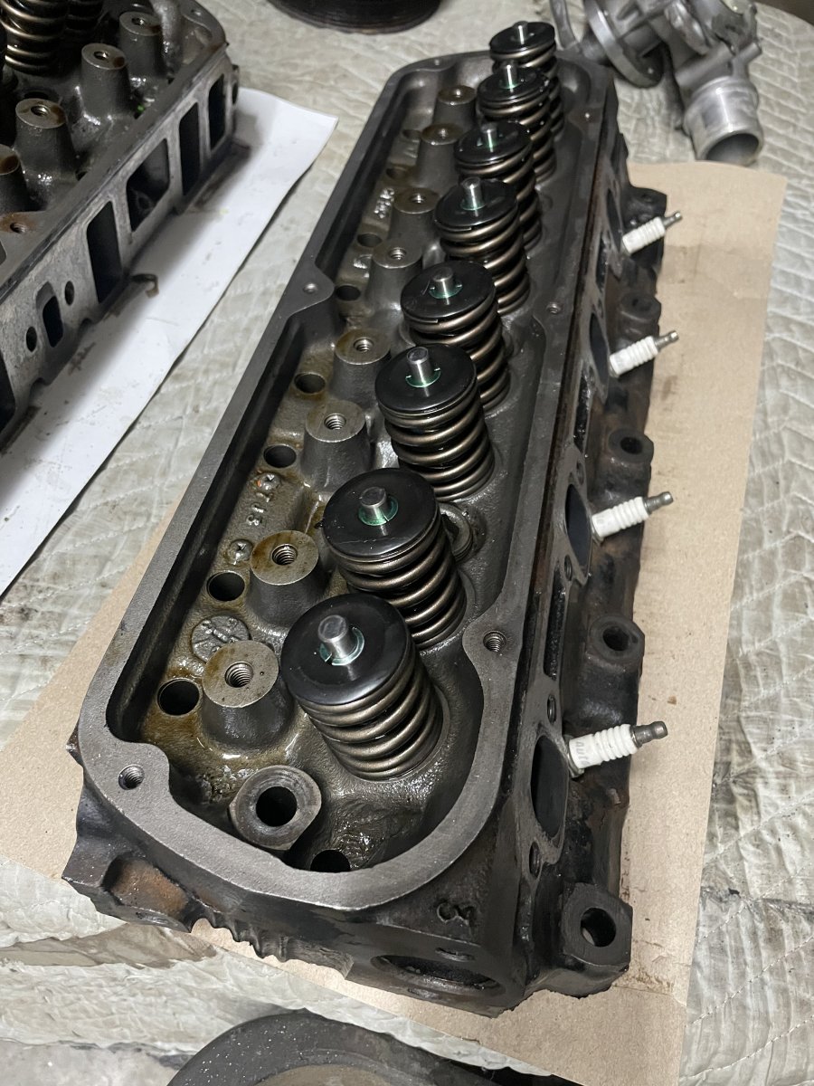

I also have some Flowtek 180 heads to sell still, very good choices for a mild 302 with nice camshaft and compression(plus tuning). Heads are crazy expensive now unfortunately. What used to be $1200 for a good brand nice head, now those run $1700 for almost all. Top level brands and power flow, those are now $2500 a set easily. Lower level stuff is still $1000 or so, and the quality and features suffer versus the upper brands etc. Mine were gone through by Thumper, and old well known GT40 porter. I had a custom cam valve spring kit swapped into them, so they are set up for ,600" lift now(not generic cheap springs that are "good to .600"). I have $1200 in them, I'd take that now just because I don't plan to build that 306 anymore. I'll eventually make a sell thread on here and the Corral, I've been too ####.

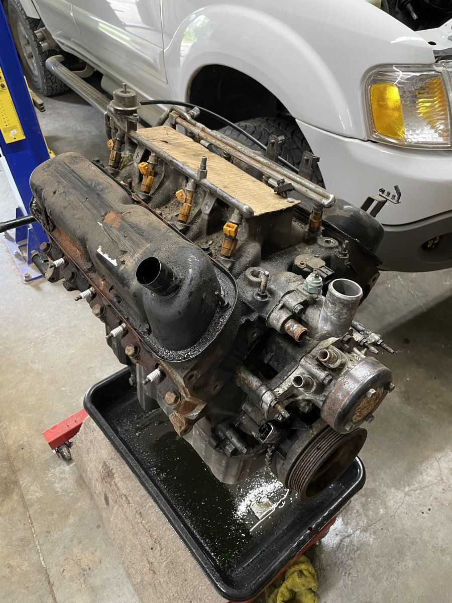

Hooked up w the dude from corral and bought the used camshaft! Thanks so much @CDW6212R!!!! Now I can fulfill my dreams hahahahaha just with a different slightly higher miles used 5.0 this time and I will loctite and torque the damn bolt

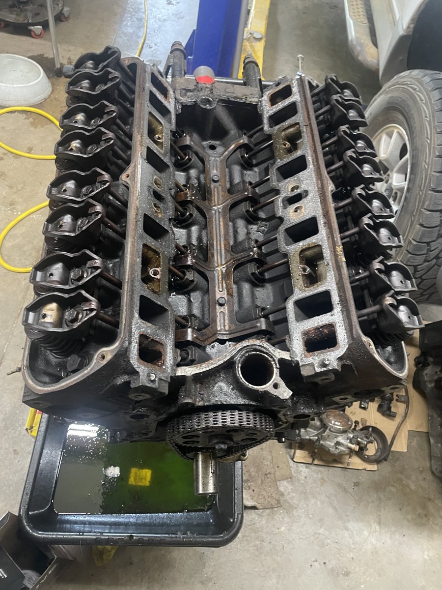

This 5.0 looks like it was run hot a time or two
Ran fine a few months ago before I pulled it. This will be the new power plant for the $700 trac
I will be using the xr264 cam springs and pushrods I will also
Change the Valve stem seals

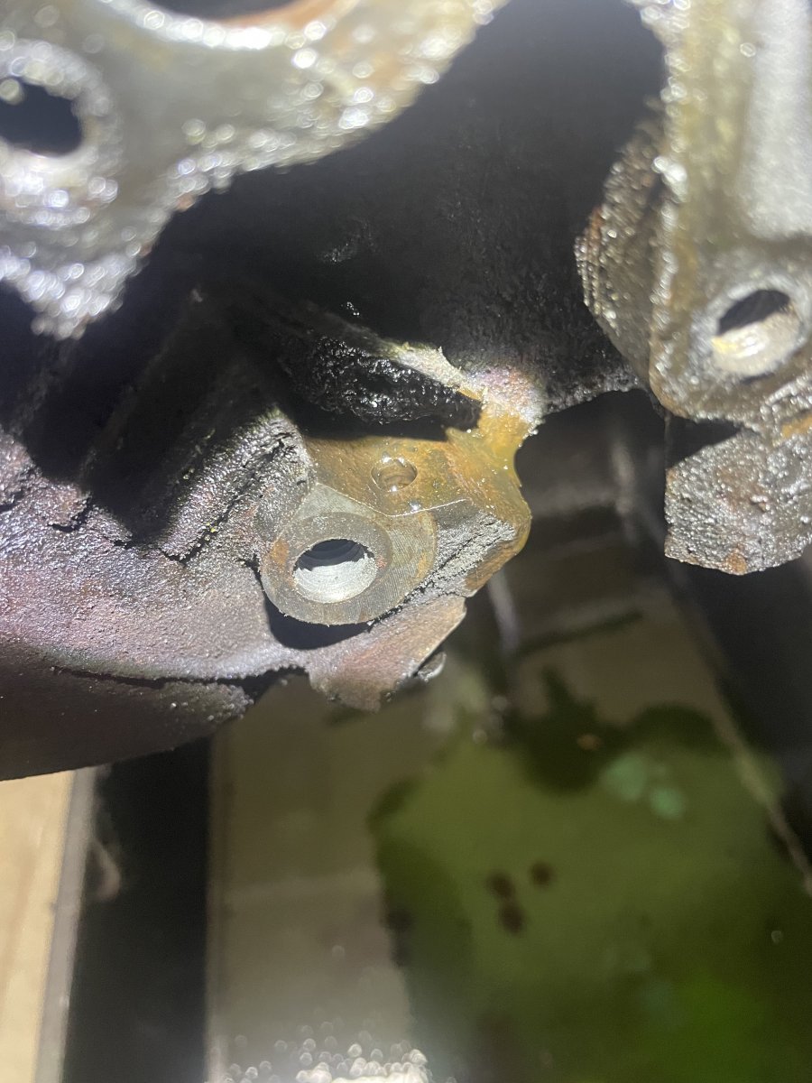

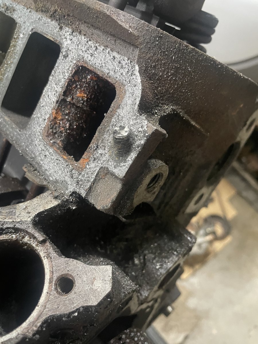

And of course the two front most bolts in the lower intake snapped off. Working to extract them now (torch)

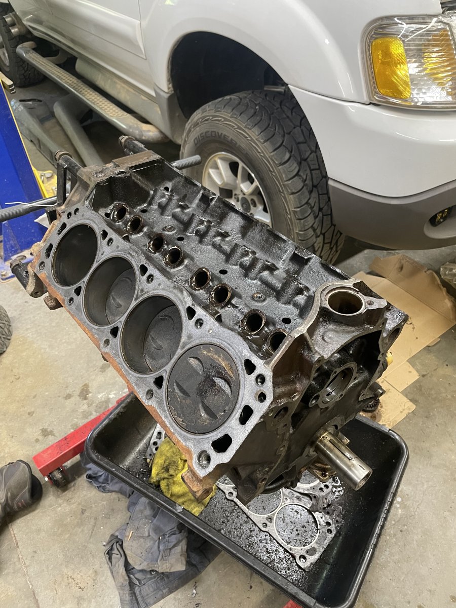

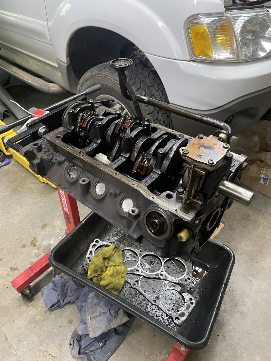

I tore the block down and flipped it upside down,
Cleaned out the holes and soaked these with pb blaster overnite
Cam has shipped! Waiting on parts to put this engine together then drop it in

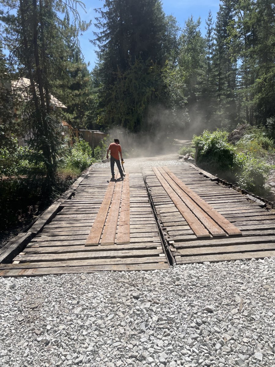

It will happen! We had to rebuild our bridge so all the neighbors got together and rehabbed it…
Finishing it up this am

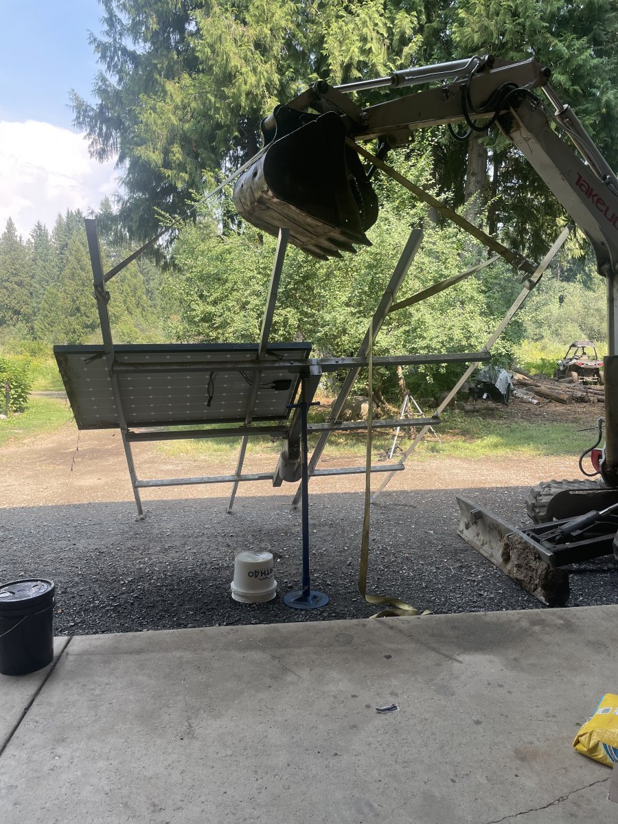

Solar upgrade is done
Bridge is done
Plus I found time to mow the whole property have been taking the kids and grandparents out on grandpas boat as well

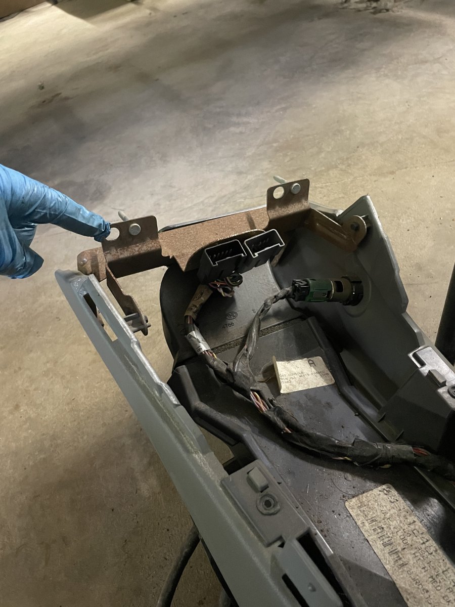

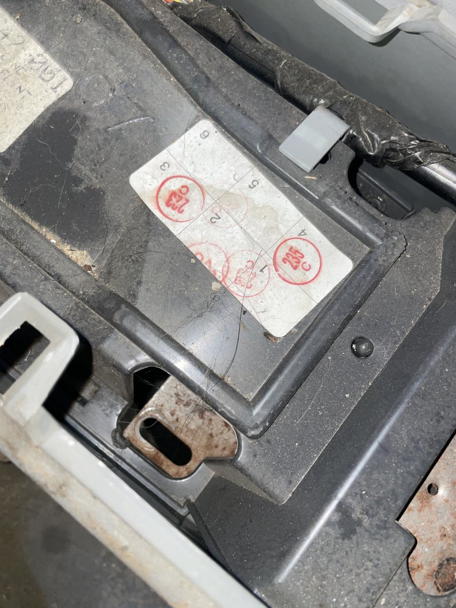

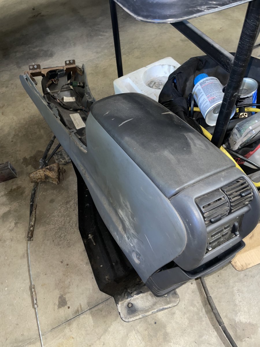

here are the bolt hole locations for the full length console!!
Two front 8mm that go in horizontal right below the hvac controls
Then there are two 8mm going vertically into the floor here, just in front of the Kleenex box
After those 4 bolts are out you wiggle it side to side a bit and then a firm pull rear ward towards the back seat and the console will release
All my parts are in, I was waiting on remflex manifold gaskets a timing set and head bolts
Now I can assemble the engine with new/ used cam hopefully have a running trac again by tomorrow
This is a 97-98 5.0 unknown miles was told “under 100k” it looks to be low mile inside but also quite a bit more carbon then I like to see, looks like it was run hot a time or two. It ran perfectly before it was pulled. This was in the black sport trax.
All new gaskets fel pro and remflex exhaust
Comp cams timing set and felpro head
Bolts. New Murray ac compressor this time around too
Today it’s getting new/used comp cam and all supporting parts all new gaskets and then stab it to the 5 speed!!

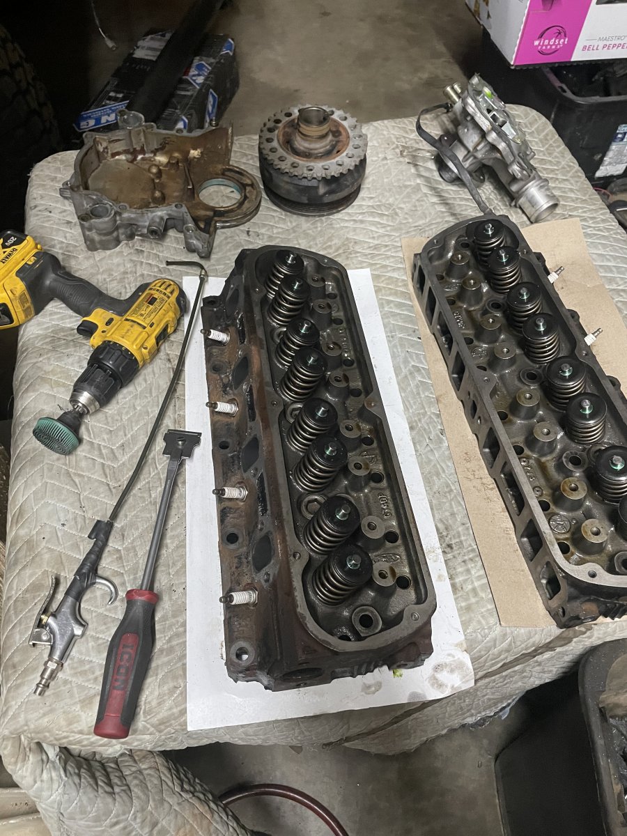

I’m running the heads from the other Jasper reman already have the comp cam springs installed
Ready for gaskets!
