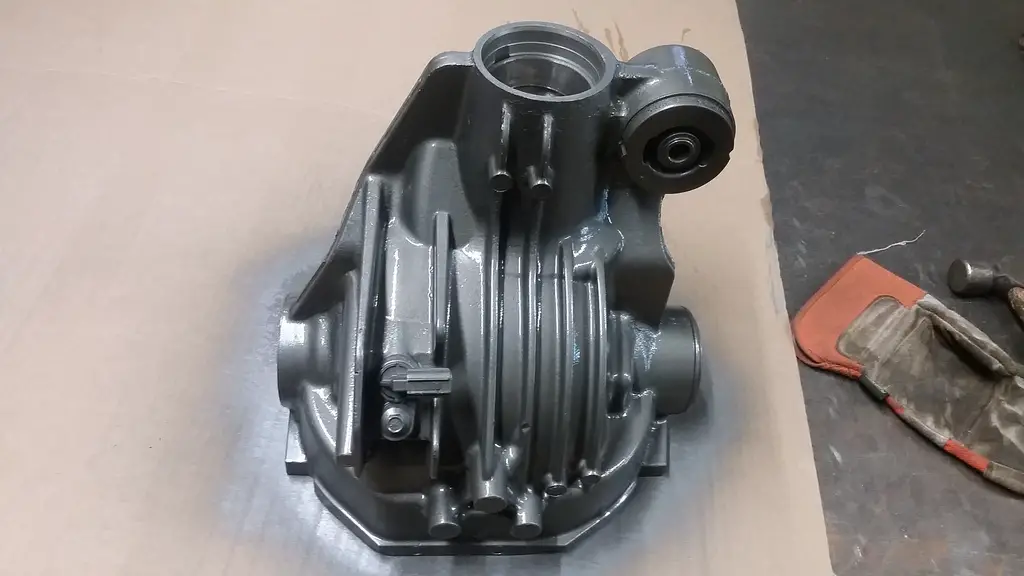

Well pulled one of the 3 diffs i have apart tonight, i have one 3.55,one 3.73 and the one in truck thats a 3.55..i chose the 3.55 one thats not in the truck as the 3.73 is more desirable and i now have it sold..
The 3.55 had writting inside the cover in paint pin,said ""pacco" and some numbers..i dont know what that meant but it has newish Timken bearings in it so its been rebuilt. .
I forgot to get axle shaft bearings so overnighted them from advance, i have all new timken bearings/seals for it already. .
Degreased,pressure washed and bead blasted the case and cover(ive got a new blasting cabinet at work :) )..looked brand new but as the normal it got painted...and yes BLUE!! Haha tomorrow going to throw it together and try to set it up..

Some pics..
