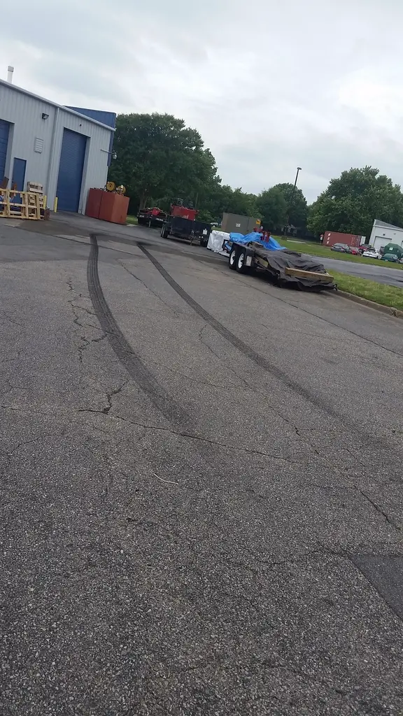

So made a little video for your enjoyment
The new LS is definitely working good..
That thing sounds pretty good. Nice burnout.
