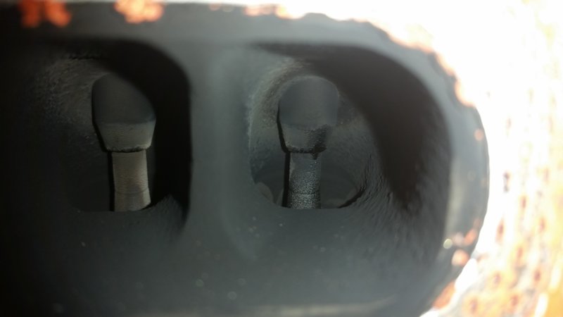

The valves in the old heads look like they have a rough surface on the stems.
I wish he touched it up by hand but what looks like ridges or transitions are smooth as hell and cant be felt with finger,the camera exaggerates transitions or whatever. ..
The old valves were cleaned up and checked for straightness ,i noticed that also and asked ..they are also SS valves and new heads are stockers,couldn't afford another set of SS

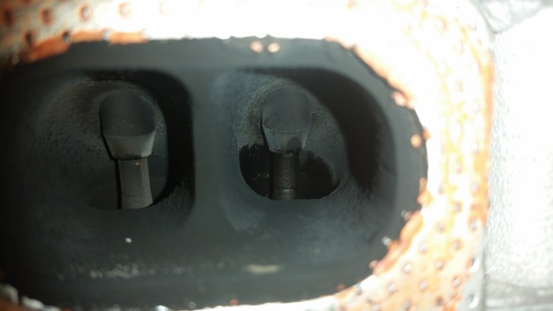

Its just crazy the ports and intake manifold are pretty bone dry but yet there is PUDDLES on every valve and can see where its ran down the valves...
I PREY these new heads fix it...

Even some of the exhaust porta were soaked..one per head was drenched in oil..
Interesting. Let us know what the machinist says about what was leaking, the valve seals or the valve seats?

Its the guides..a very very slight amount gets by the seal to lube the guide but if the guied is to loose it will suck a large amount of oil past the seal...

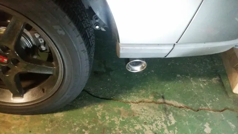

Vrrooomm vrrooommm..early bday present to me (bday is 11/11)...

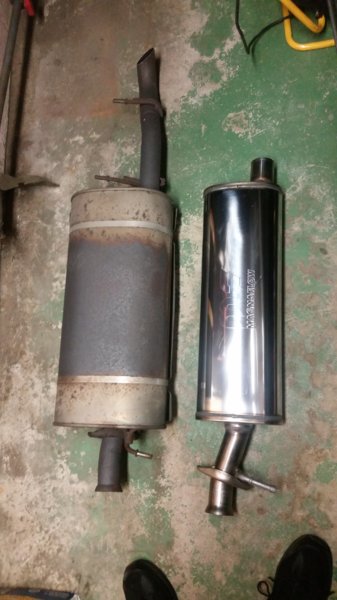

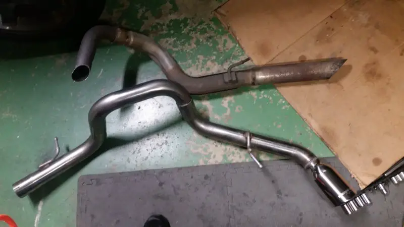

Stainless steel MagnaFlow Cat-Back exhaust..hope is sounds better than the price tag...lol
She's in,took about an hour..sounds really good,definitely very happy with it..
O side note Abacus gave me a full refund ..Chuck is the most stand up guy and the definition of what a shop manager should be..He went above and beyond to work with me..
That exhaust looks and sounds awesome!
Time to get back on that Ranger and set some new records!
