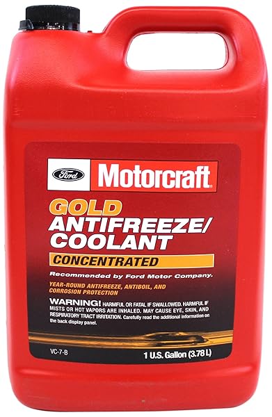

You all be sure you're using the correct coolant after flushing now ye hear! Using the incorrect coolant (or never ever changing it) is probably what caused the clog in the first place.
One should only use one of these:
http://www.oreillyauto.com/site/c/detail/AFZA/G05/N0496.oap
http://www.oreillyauto.com/site/c/detail/AFZ9/FLEET/N0496.oap
Or if you are rich:
https://www.amazon.com/Genuine-Ford-VC-7-B-Concentrated-Antifreeze/dp/B000NU3T3W/
  1. Zerex 5/100 (ZX001) appears to meet Ford's ESE-M97B44-A spec.
