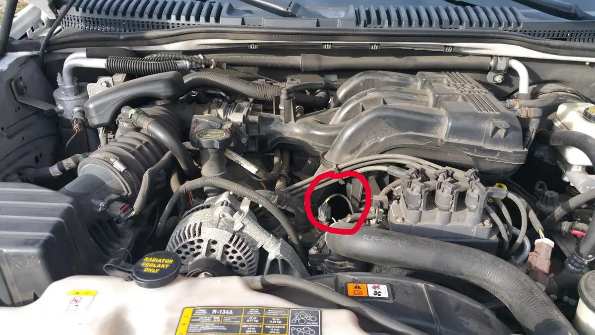

A family member had noticed that it looked wet in a specifc part of my engine while we were taking a look and refilling the coolant. I had noticed something similar a while back, but I was foolish and thought it was just rain. I think that was a mistake :P I use 50/50 coolant and the level always seems to decrease after driving for a few days.
This is the general area of the leak.
You can see how it's reflecting from my flash. With this photo, you can't really see it well, but there are two little puddles. I used a paper towel to soak some up and it's orange, which is the color of my coolant.
Can anyone let me know what the heck is going on? Can I fix this?
30 bucks will get you a doorman one off amazon. Lots of guys don't like them but mine is 4 years old, and been off 3 times (I suggest saving yourself the time and swap the thermostat while your in there) and is still going strong.
Do a search; tons of how-to videos/directions.
IMO, do the whole assembly while your taking it all a part anyway. (upper/lower housing, thermostat, sensor and all gaskets/o-rings) I even replaced the small heater hose coming off the lower housing. DO NOT over tighten any of the bolts; its all plastic. Personally, I like Motorcraft, but there is a Dorman kits with everything except the sensor for half the price. Easy, just take your time.

Got the Dorman part off rockauto.com that comes with the thermostat in it. Bought a new sensor too since I figured the o ring would be damaged (it was!) just make sure you're very careful not to loose the clip that holds the thermostat in... it'll cost you 15 bucks at the dealer if you can't wait to order one online.
Overall the repair was easy and took maybe half an hour. you can make it easier by disconnecting a bunch of stuff but it's not required

A family member had noticed that it looked wet in a specifc part of my engine while we were taking a look and refilling the coolant. I had noticed something similar a while back, but I was foolish and thought it was just rain. I think that was a mistake :p I use 50/50 coolant and the level always seems to decrease after driving for a few days.
Probably your thermostat housing. It's made of multiple pieces of plastic. My 4.0 Explorer just did the same.
Get the aluminum thermostat housing off of eBay, get an oem Motorcraft thermostat, and never look back. You won't ever have to touch it again if you do that.
