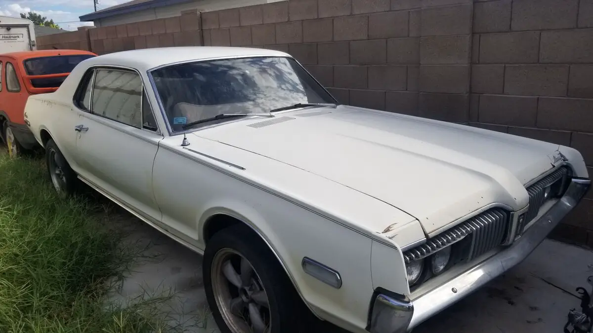

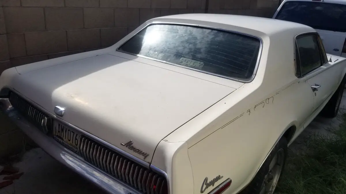

@Josh P It work out ok? I'v never put an AOD/4R70W in an early Mustang...I'd like to see a picture of the Cougar
The 4R70W is a tight fit. There are 2 tabs on the trans housing you have to cut off for it to fit the tunnel. I swapped an explorer 8.8 in at the same time. The car has traction issues in 1st and 2nd gear. The red car behind the cougar is my XR4TI.

Nice! Brother has a '67 289 cougar up at his house in Tennessee. We have a few misc pieces for '67-'68 Cougars...
You must have narrowed the 8.8?

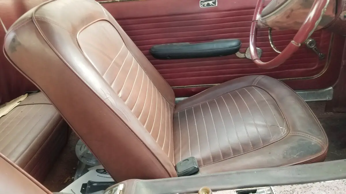

This one needs to be restored, it is mostly original. The chrome is getting pitted, interior is dried out.

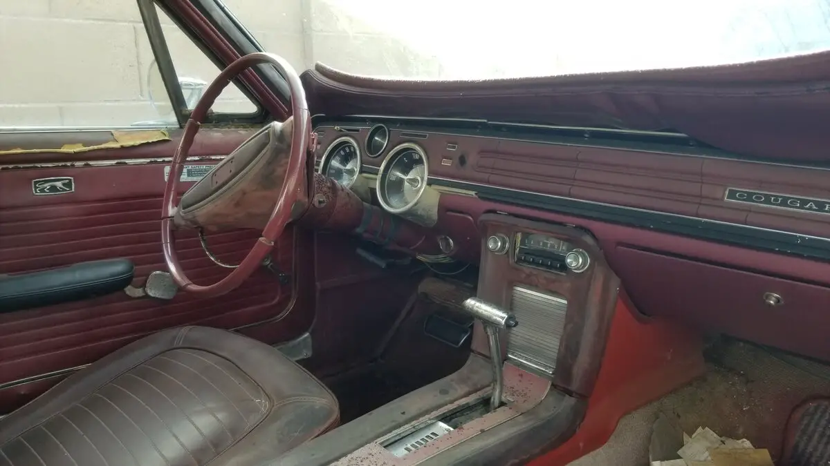

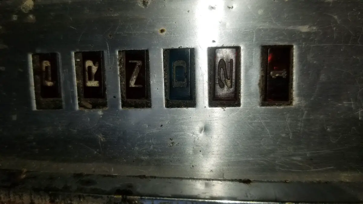

is there a conversion for the gear indicator window? cause that is cool
1,2,D is on the indicator. I haven't wired a switch to turn the O/D off
I asked because I swapped a 700r4 into my 64 Impala Convert, and there was 1,2,3,O that popped onto top of steering column
Nothing on the column. When I restore the car, I may get a different shifter.

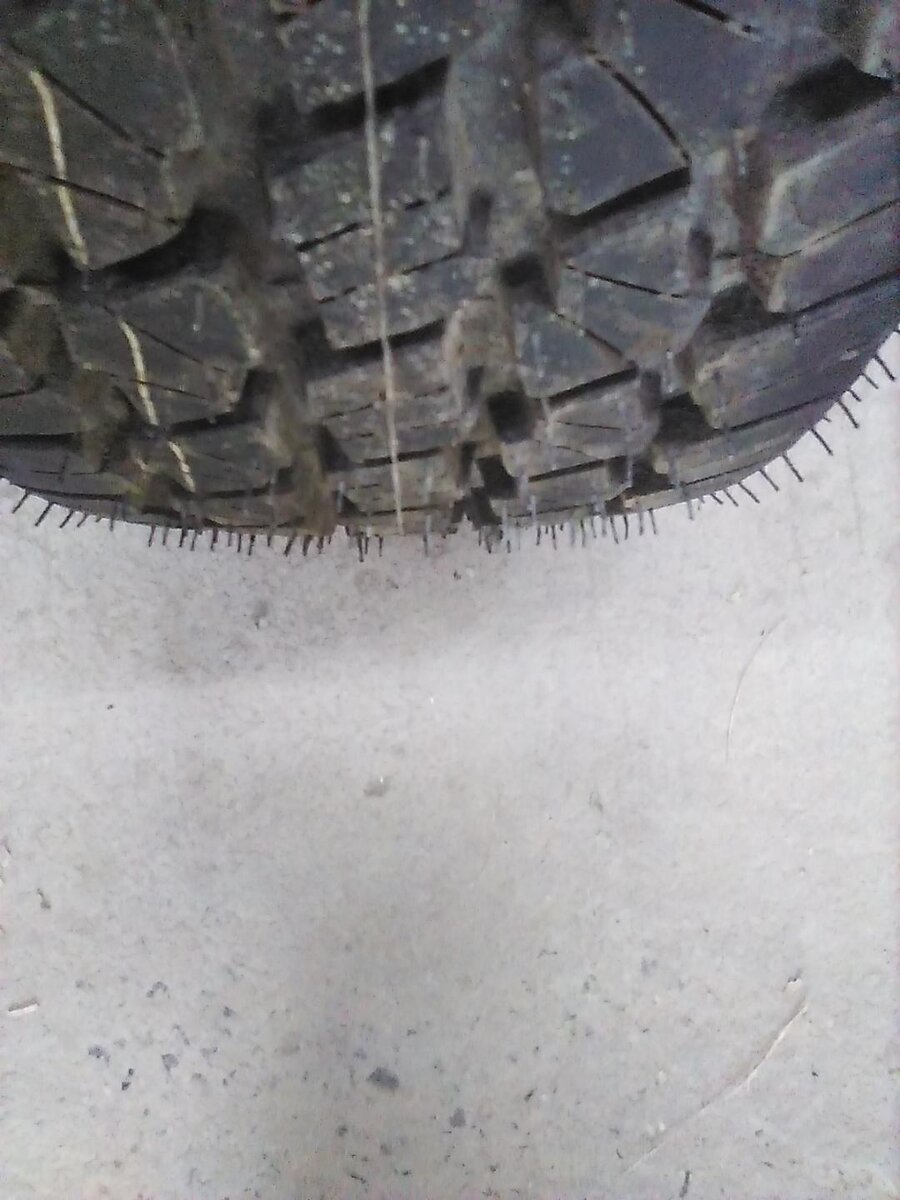

Tire nubs

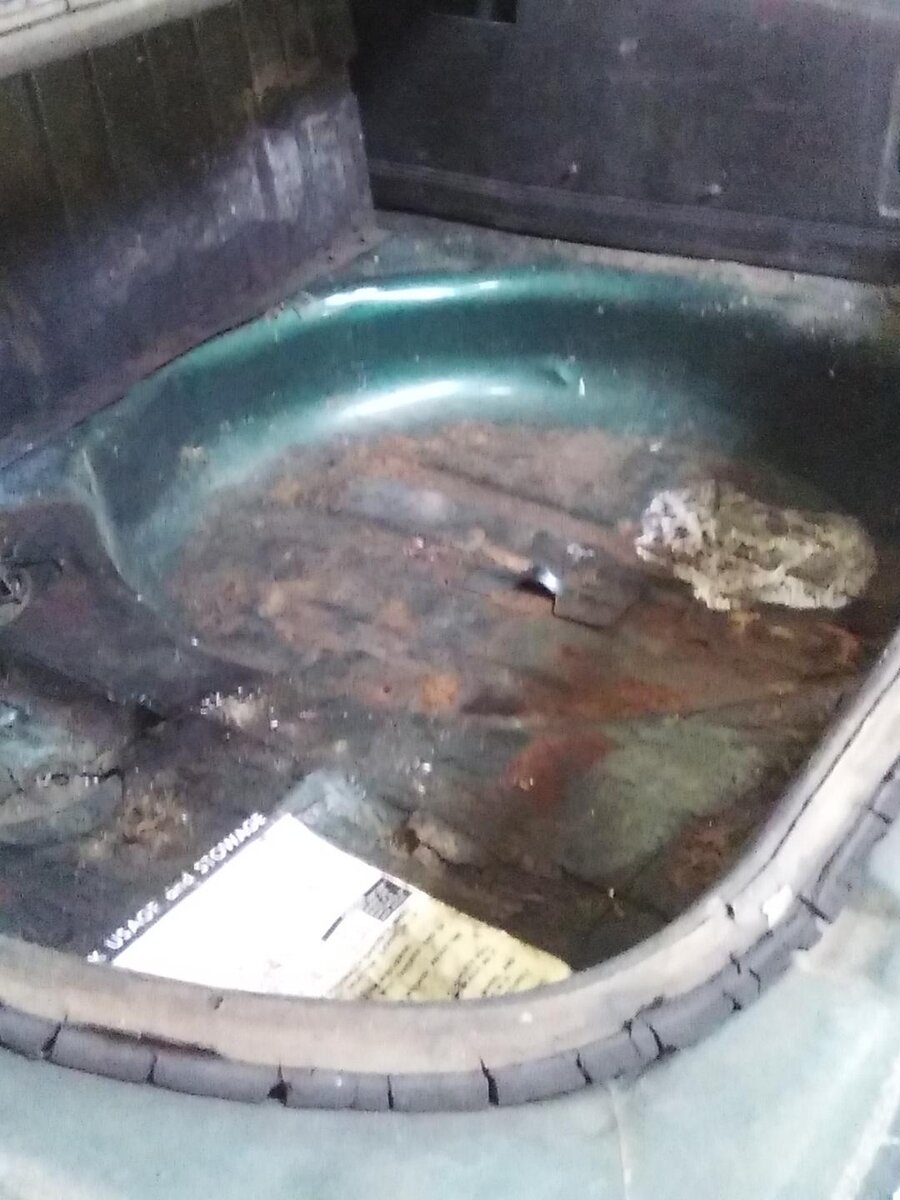

Picture of the trunk

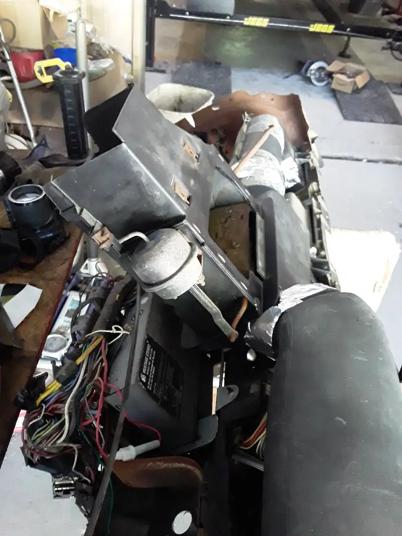

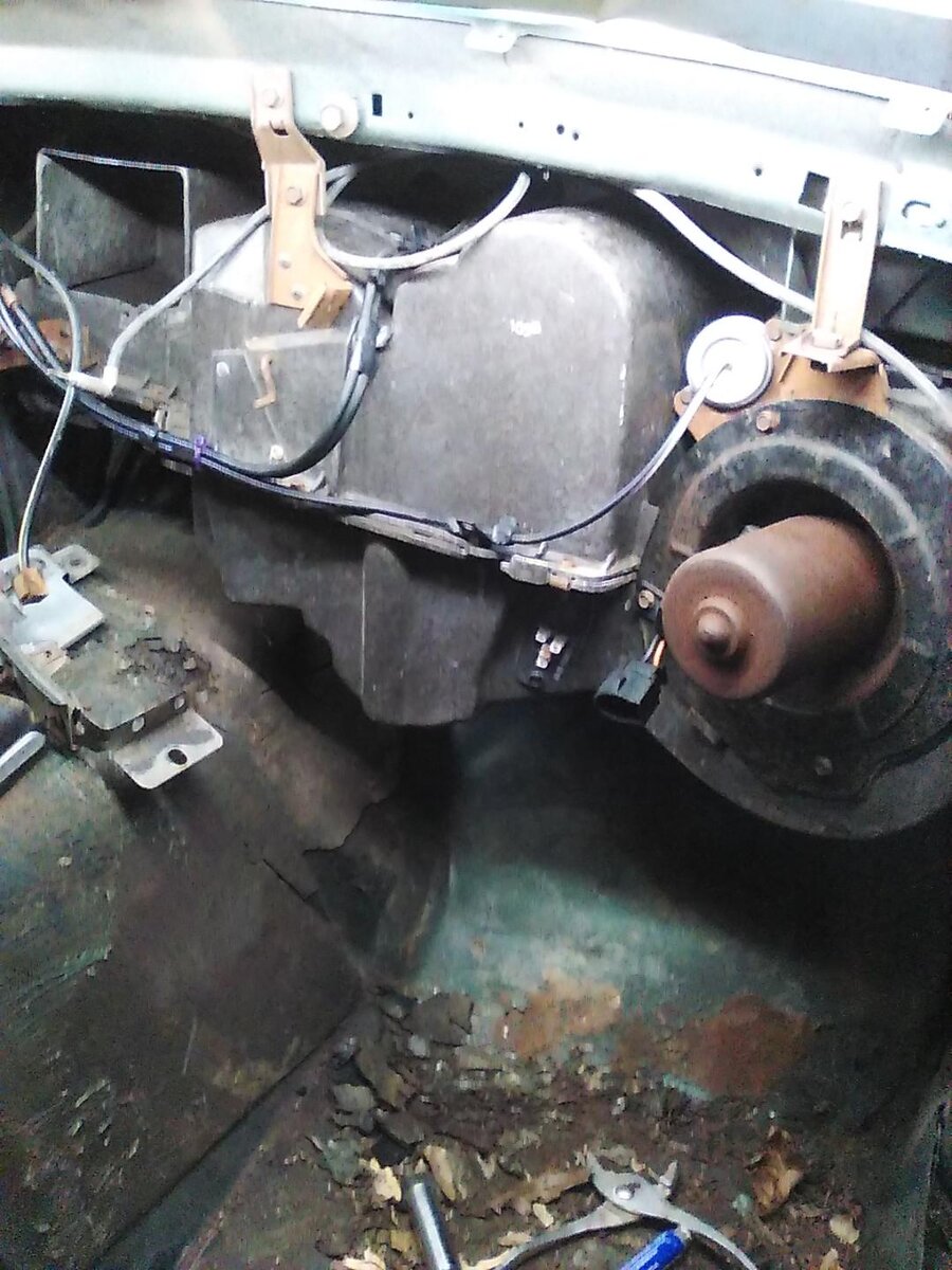

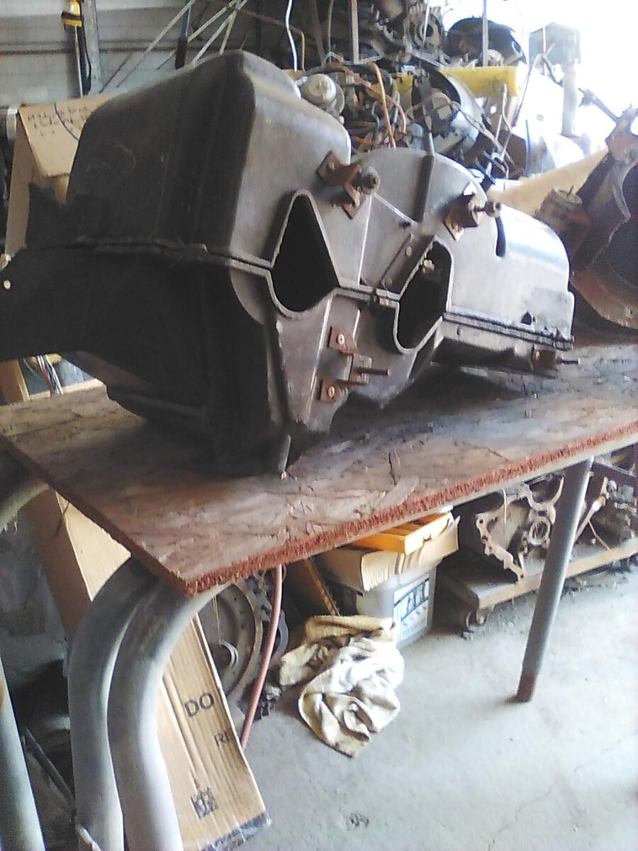

We had 4 tires with new valve stems installed at WT&A. Also cleaned and repaired AC/heater box

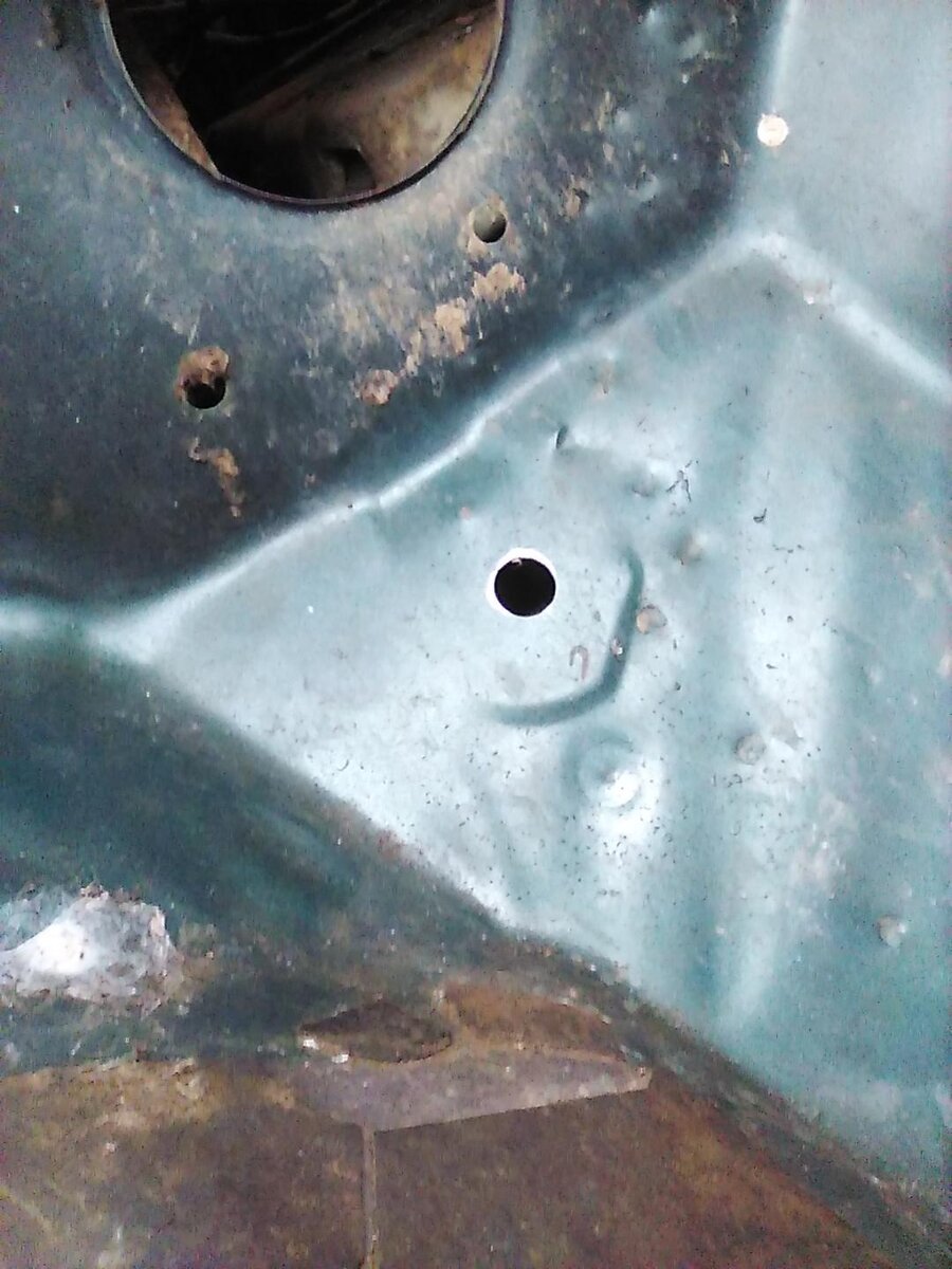

Hole in floor for AC drain to exterior

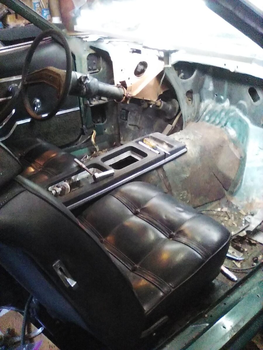

Column in...
The AC/heater box is installed.
AC/def plenum blend door on the way from Virginia

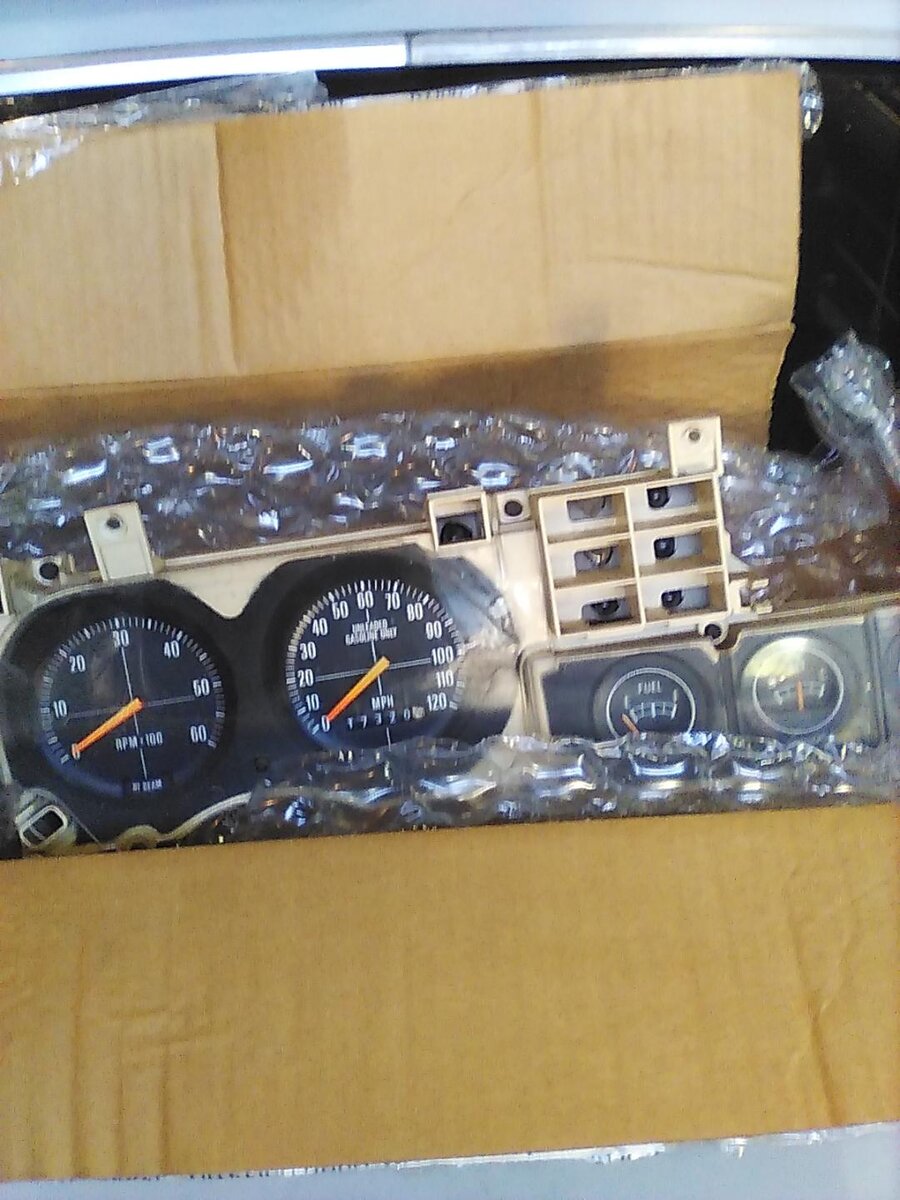

The one good instrument cluster surfaced. This is on out of 4 or 5 that were removed didn't crumble
It was good to find them seeing as none are available on Ebay. When brother found them, he said he remembered wrapping them
in bubble wrap and boxing them up. That was 15 years ago...
This adds to the value of the vehicle

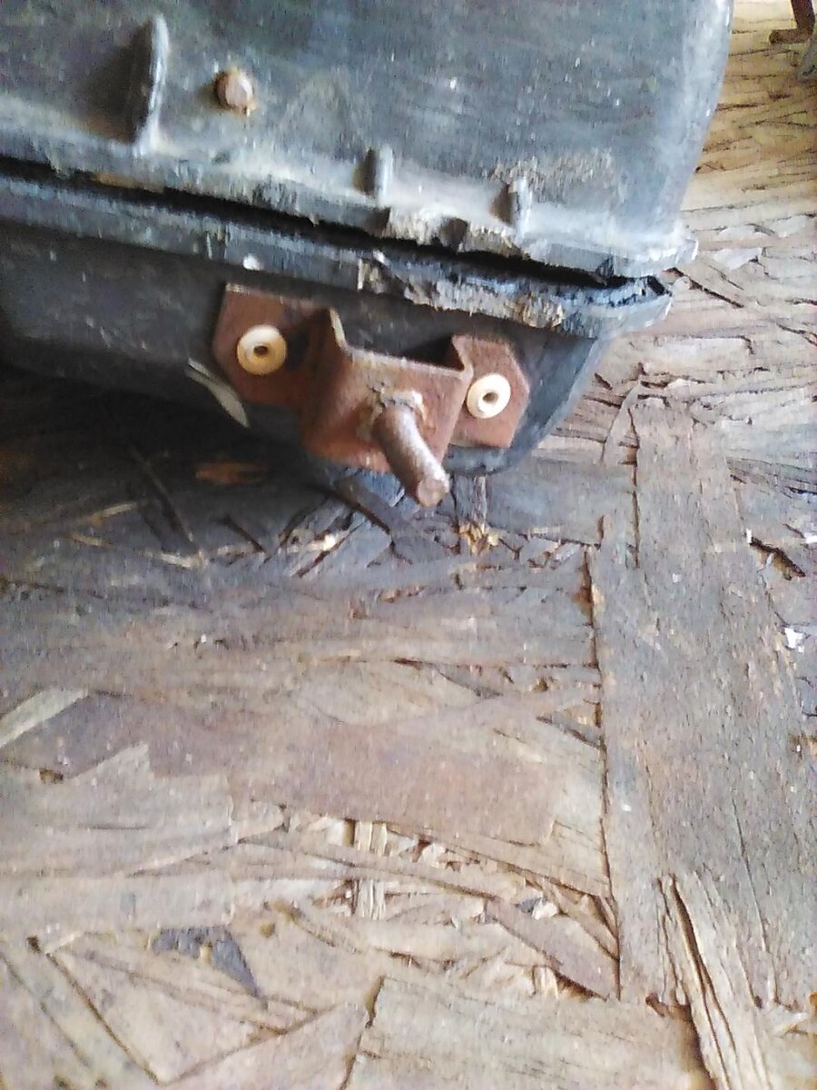

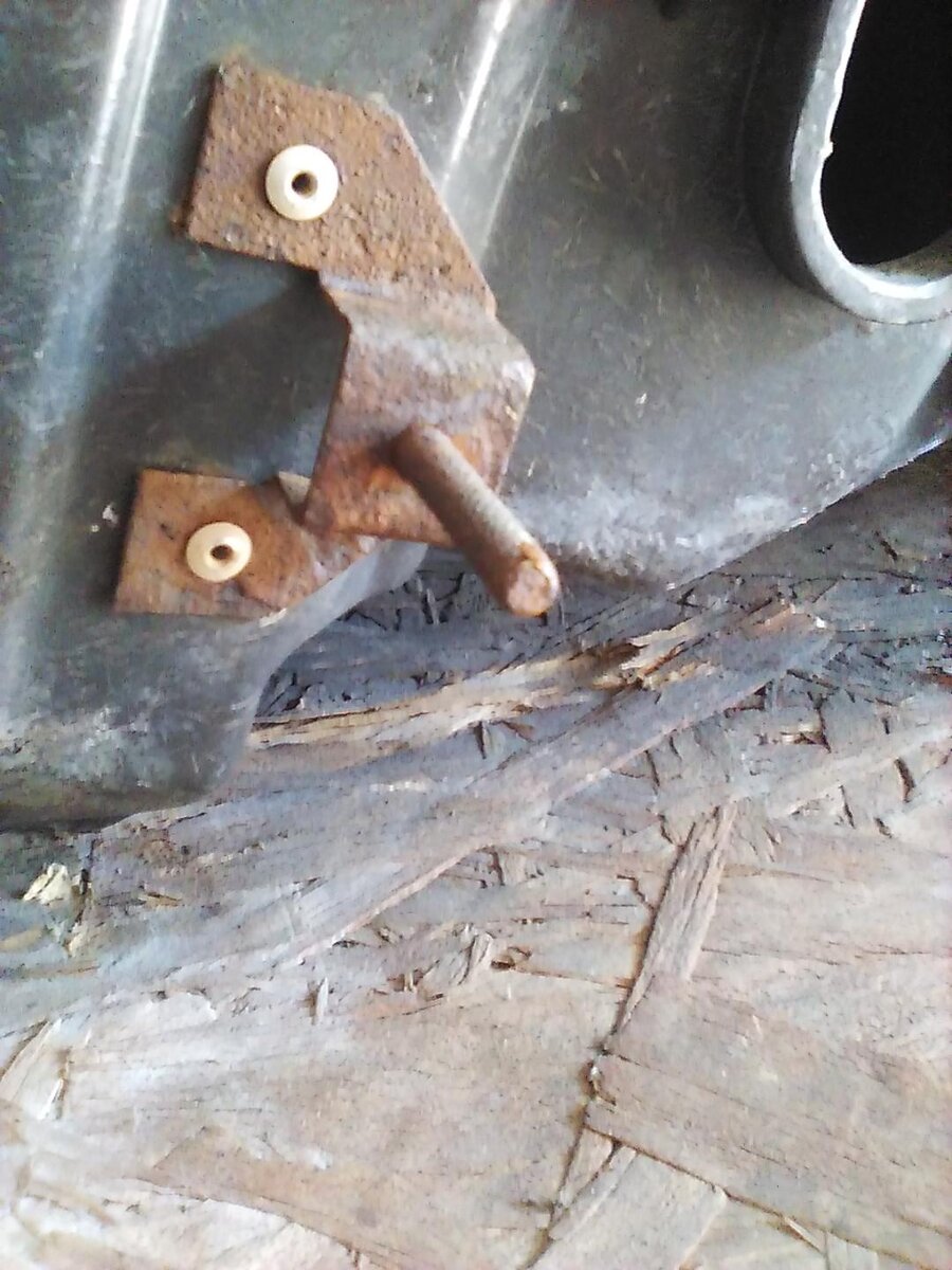

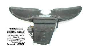

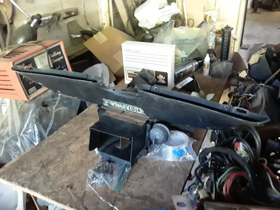

We had to look on the internet for an AC defrost plenum blend door assembly. We got lucky and found one on E-bay.
Defrost plenum
Defrost vent/dash vents blend door assembly
Good find, those are scarce for sure.

I guess that I didn't realize until after we purchased the defrost plenum and blend door box thing that that was 2 pieces that we were missing entirely. They are in pretty good shape 4 44 years ago and one piece has written on it "M II Cobra".
