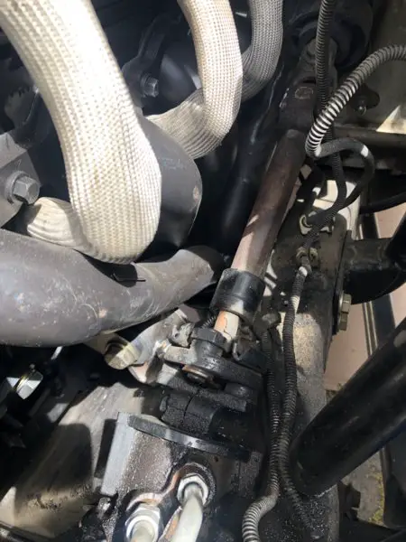

It looks like the steering shaft clears the headers by plenty.

Here some pics of the header clearance and ended up switching the truck accessories to the Holley mid race accessories
That appears to fit way better than a 5.0.
