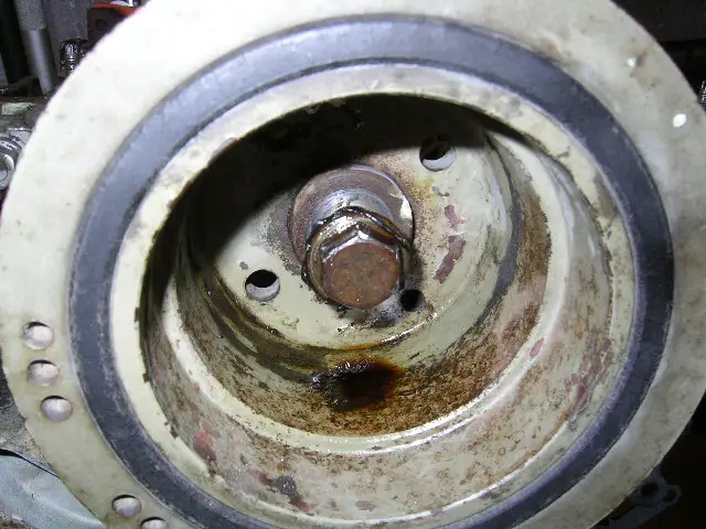

1. Loosen harmonic balancer bolt. I used some heat and an electric impact.

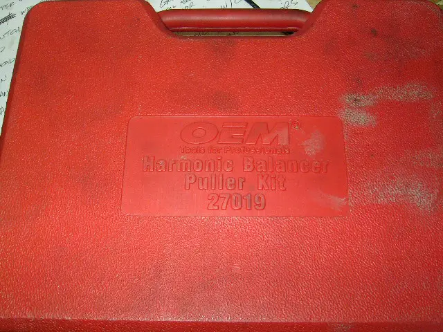

2-3. Get a puller kit. I rented one from a parts store.
4-5. Install puller. The bolts that come with it probably won't be long enough so find some that work to thread into the balancer. I used intake manifold bolts, but bent one, so a junkyard trip is planned.
Grease the threads on the main screw before installing it into the puller. I used anti-seize.
You're pushing off the old crank bolt, so unthread it a ways to give range of motion. Then screw the puller main screw against it.
It will go quite a ways off the crank so you'll have to stop to unscrew the crank bolt a couple times.
6. Eventually you will be able to remove the balancer by hand.
