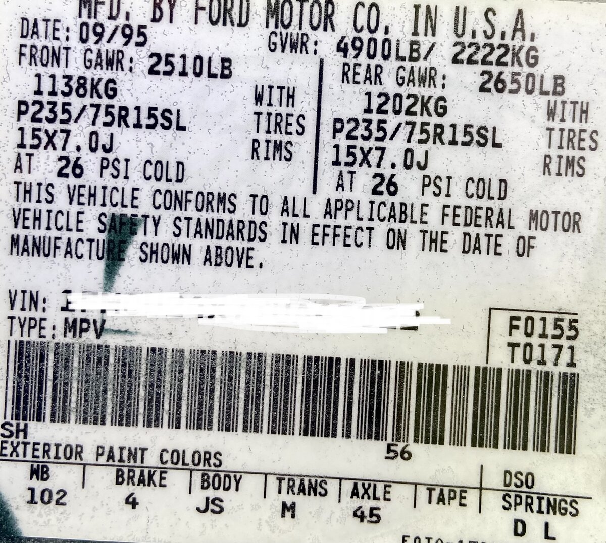

Door tag will list something abiove where it says AXLE
D2 or D4 very common in 96 sport with the 5 speed!!!

45 is 3.55 gears open differential (No limited slip)
That stinks!!!

Here’s the door sticker for those who would like to define the details

Hunt the rear AXLE codes with letters in them, and not the numbers only code like you have. The all numbers codes are open diff's. The LS diff's have a letter in the axle code, such as D2 or D4 etc. Find the later 2nd gen's with lower mileage best, those have more predictable gear ratios, the 3.73 and 4.10 are more common nearer to 2001. The 302's all came with 3.73's as far as we know, the later 4WD V6 2nd gen's often had 4.10's.

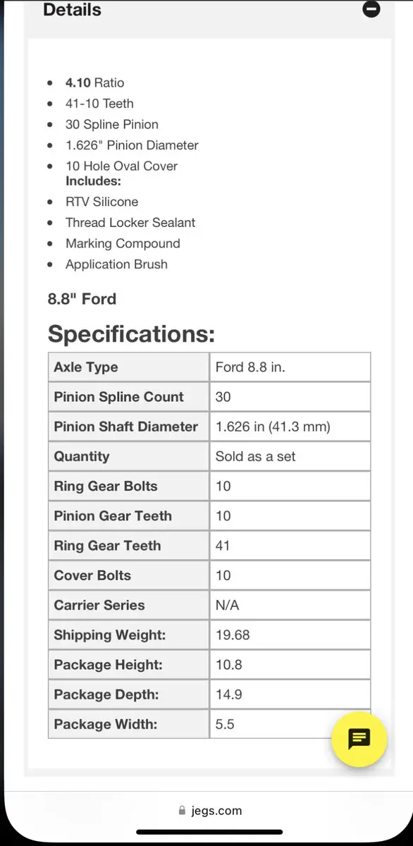

also im not sure, i dont rememebr an 8.8 30 spline? i thought ours was 31, and the rangers had a 28? dunno.

oh, in that case ;) sounds good then! just not sure there was ever a 8.8 30 spline?

The Explorer axles are all 31 spline, the early Rangers had 28 splines like most cars did. For the R&P the axle spline doesn't matter, any 8.8 normal rotation gears fit all 8.8 rears. I think there were some rare front diff/reverse rotation gears, skip those if they exist.
