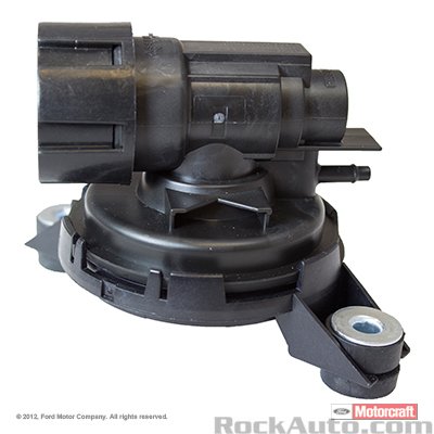

For many months now I have been having a very strong fuel smell that I have been dealing with. There are not any raw fuel leaks visible and there is not a fuel mileage issue. I've read the PCM many times and clear it and the only code that will pop up is P0455, gross leak detected. And it is gross. When the engine is shut down you can smell it and it smells like it is in the front left fender area. I replaced the Vapor Canister Purge Valve / Solenoid with a Motorcraft one and no change. This is located above the left front inner apron.
Many say that you can access it under the battery. I preferred not to do it that way and risk breaking a 24 year old plastic line or connector. It didn't make any change in the condition. Instead of the expensive "parts swapping" method of diagnosing a problem I purchased a $150- smoke machine. I was finally able to get the vehicle up on our only lift at the Shop. 3 of us spent 30 minutes with the smoke machine hooked up to 2 different places and looking under the hood, front to back under it and looking at the top of the tank and the only place that a little wisp of smoke came from was the seam of the air filter box. That is not where the smell is coming from and a filter might help that isolated issue. When you use a smoke machine do so in a well vented area. Burning baby oil produces carbon monoxide.
