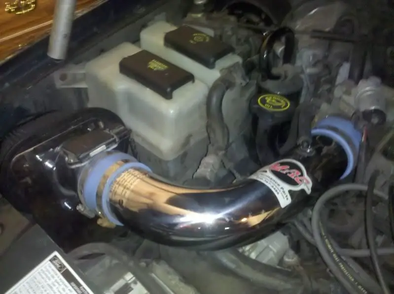

just put a mac intake on my friends 00 V8, made it a hell of alot louder
that looks bad ass! i will definitely look into that! i'm digging it big time. what are the pros and cons of this over, say, the KKM kit... or the K&N kit?
