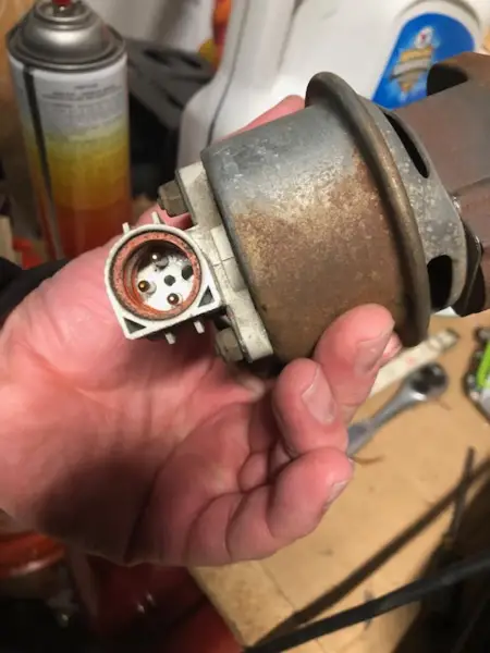

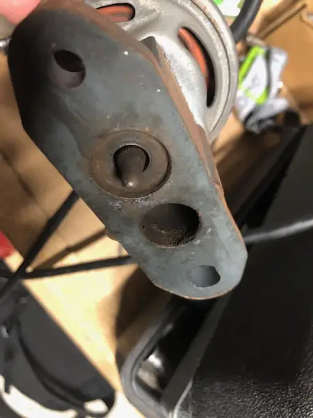

Well I finally got around to pulling the EGR on my Mountaineer, and it does not look nearly cruddy enough to get stuck open. I took a stab at testing the EVR with and ohm meter and got the same results with the valve all the way open or all the way closed - no continuity across any pair of pins. Too me that points to the EVR being bad - is it serviceable or is it just included in the new EGR? Is my EVR test remotely useful or am I doing it all wrong?

Those are junk, I had that style on an 85 302 crown vic. You should vacuum test it first of all to see if the pintle moves off the seat. You may be able to use engine vac. I think there is a solenoid that controls it too, it could be always open and letting in air (I had that issue too with the 85). There is your excessive flow.
I know I had issues with it at high mileage, both the valve and the sensor. Clean the pintle. You can check the pot on the ohm scale as the position changes. Not sure about pinout but it should be easy to find. You can certainly remove the pot and replace as an assembly. I looked up the part and it is the same as the old crown vic.
So, either the pintle isn't sealing or the sensor is messed up reporting the wrong position or the solenoid is bad. Best bet could be a scan too to see the egr voltage at idle. Look into forscan.
