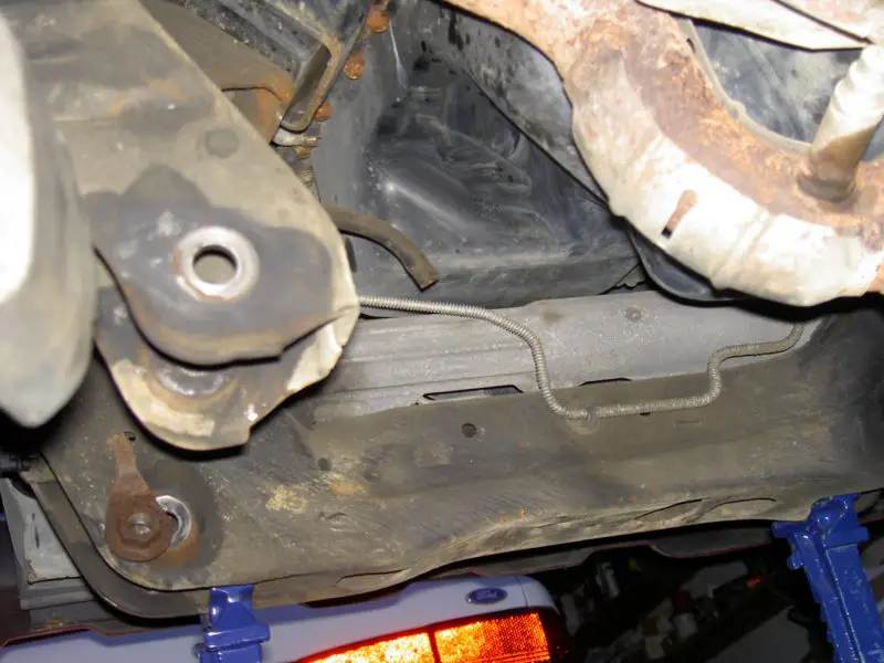

That front diff/hose is supposed to be clipped to the front of the left shock tower frame part. It's tough to move that without removing the differential itself. I'd bet the diff was out, and when it went back in, they forgot to route the hose up first, and it's hanging. I doubt it can be put back with the differential in place.
The first picture shows the vent hose hanging down, I removed it from the diff, the first time I had it out of my Mercury.

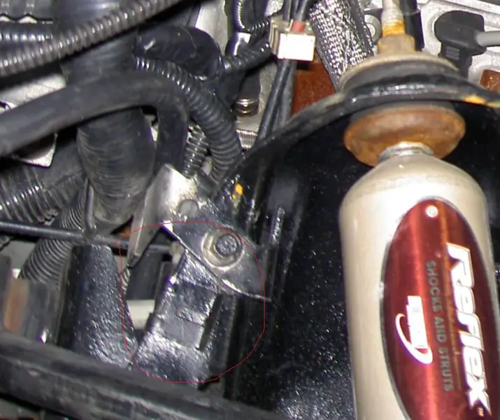

Then below, I circled the hose mounting clip, in the center of the red, it's barely visible from the outside. You can barely see the white of the plastic vent of the top of the hose, behind the frame edge.
Great info! thank you very much.
