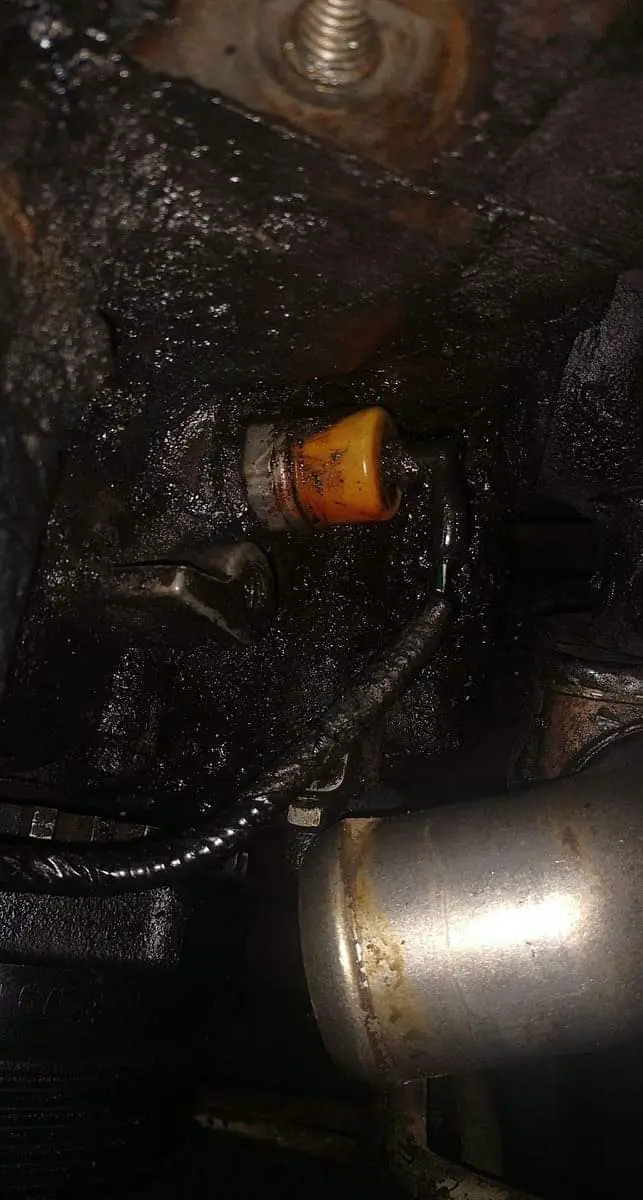

I was wondering how it was so dirty down here. Timing cover leak mixed with who knows how long an oil leak from the pressure sensor. Something else to replace it's piling up!
I feel that, my black one was a mess there too. I replaced the pressure sensor and the oil filter adapter gaskets, and I still had a leak from the front main seal and oil pan. You will be happy to get those done, every step to stopping the leaks helps with the next one, finding it at least.
