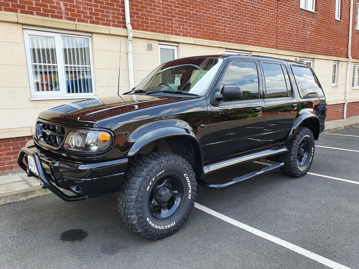

Yeah, still here, my Explorer is a little different than when I got it. Hope we can all make it to a get together next year!

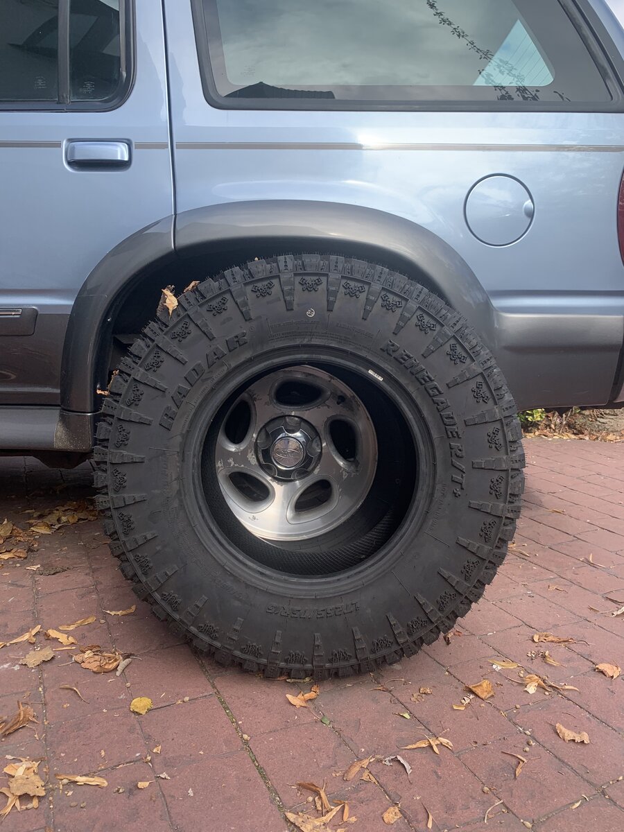

Figured these were of 100% top quality as they have skulls with pistons crossbones, so I’ve brought them with no hesitations.

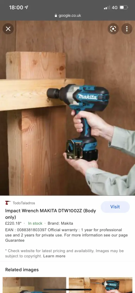

Hey Jan - the warrior shackles are planned to go in when the OME leafs appear. I’ve just brought the most impractical enormous impact wrench I could find and it needs something to do to qualify the purchase.

It sounded but like a machine gun and that’s what’s sold it for me personally.
