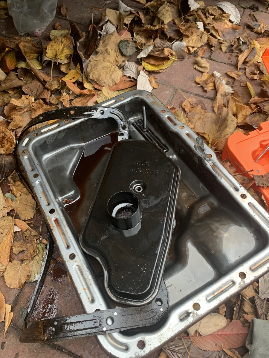

The 1 hour job took 1 day! Had to remove driveshaft to drop the pan. No nasty looking gremlins in pan either. Going to re-torque the VB bolts tonight and fill tomorrow!

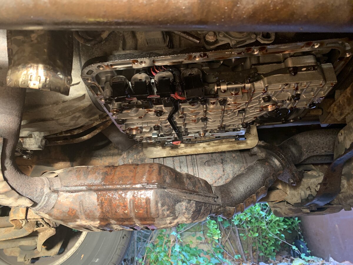

Boys! It worked! I tightened the appropriate VB bolts to 14NM they all took maybe a 1/4 turn. It shifts well now and kickdown is back with no stuttering.
I used a gulf fully synthetic ATF approved for Ford Mercon V from Opie Oils. It took 4 litres to underfill - 5 to overfill and I drained 1/2 L from the trans cooler lines in bits to get it right.

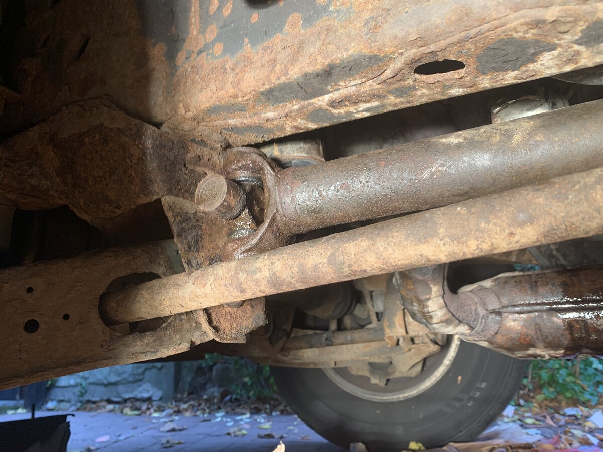

As an addition to this thread - removing the front driveshaft is essential to getting the pan drop done. For uk guys go underneath the passenger side and soak the 4x T25 torq in WD40 overnight. Remove the bolts and pull the shaft backwards to remove and tick out of the way. THEN proceed to loosen the pan bolts and drain fluid slowly from one end.

Pan drop, pan and magnet clean, VB bolts tightened to 14NM, fresh fluid and filter have solved the issues stated at start of thread.
