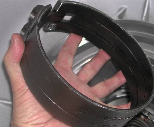

I highly recommend Lemon Grove Trans. I also lost reverse. Turned out to be the reverse band broke. All bands replaced and a TransGo kit ran me $1300.
This is the low/reverse band:
