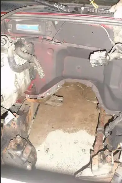

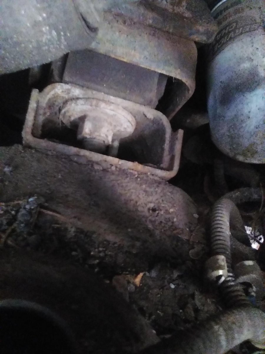

My 97MM V-8 has a lot of room being a torsion bar truck but the Ranger has a big crossmember. Before I left the house I slid under the Ranger for a minute and then looked down in the left side under the hood. I immediately saw this extra riveted or welded on bracket under the rubber motor mount and realized there are many details to consider.

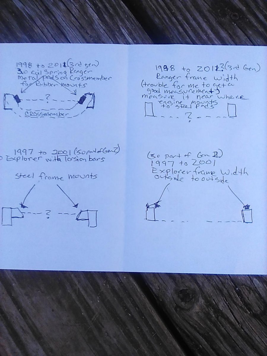

Thanks! This morning I've been working on a drawing. Maybe on of the guys/gals here can draw it up on a capable desk top PC. My wife's
little laptop won't do it. In the meantime, we will get some measurements.
ADDED: 11-05-23 Earlier I took a better look at the crossmember in the 1999 Ranger 2wd coil spring truck and discovered that the passenger side does not have the welded-on steel pad like the driver's side. It is the rectangle pieces that are colored black in the 1998-2011 Ranger drawing.

The engine cradle is mostly flat behind the rack and pinion, I’ll get pics of the empty engine bay and some measurements
(I have 04 coil spring ranger outside no drivetrain in it)

With the aprons out of the way was able to get a good frame rail measurement. O to O is 32".

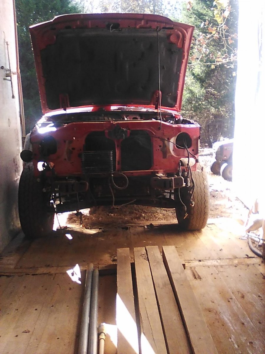

ADDED: 7:40 p.m. I did notice that the crossmember is more towards the middle of the front wheels and not to the front or to the rear.
I might could pull off an engine swap working out of the door end of the sea (C) box.
I'm at the shop where I can measure the '97 Mountaineer frame. It is 31". I was up in the wheel well area with the wheel off and the apron out, so I know that I got a good measurement. Looked at a Fox Body 5.0 5 quart oil pan too. Small sump to the front and big sump to the rear.

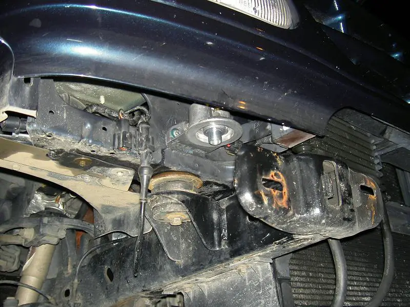

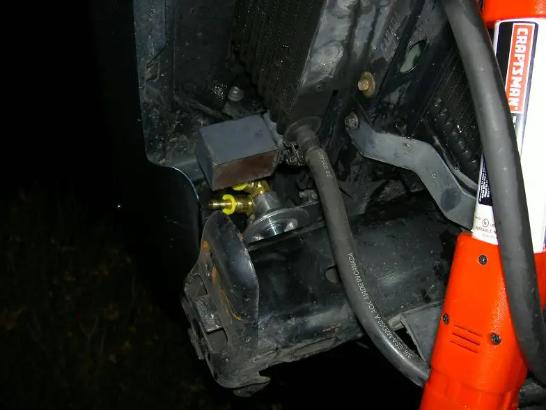

But, the oil pan you might just hunt the one that gives the most clearance and install an external filter. That can gain you an easy 1-3 quarts of oil. The filter location is a bigger deal so plan that so it is either easy to service, or not a problem at all because you replace it with an adapter to remote mount the filter. I'm going to do that with my Explorer, run two filters, one on each side of the radiator support (next to the body mount). I can fit a bypass filter (which can be over 2 quarts big), plus the other normal flow and also near two quarts.

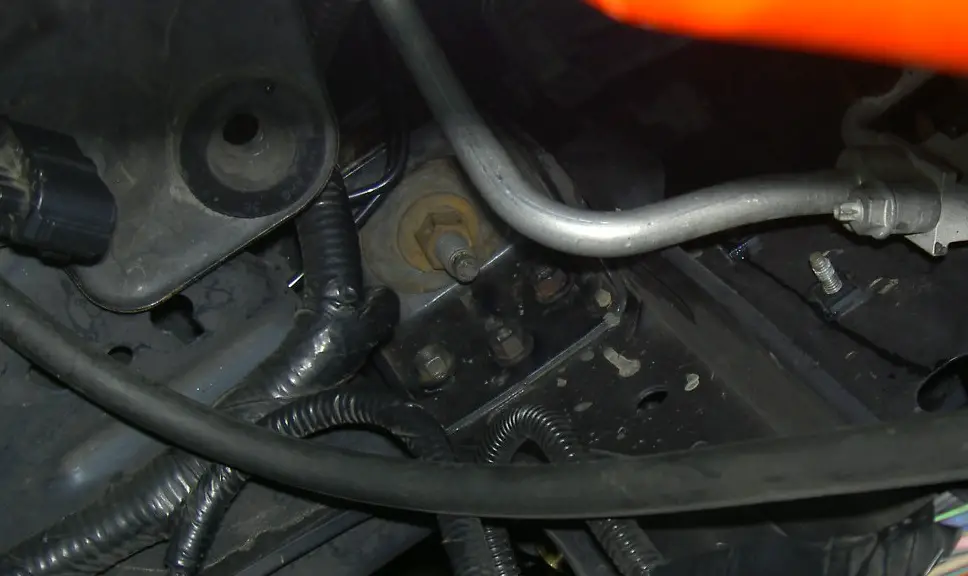

Do you mean my external filter mounting? I did this in my 99 SOHC work truck, I placed the filter in a great spot that is easy to R&R, and still protected well. I did this with the body off so drilling holes in the radiator support isn't as easy wit the front all together. This space is available on both sides next to the frame.
In the 3rd picture of the mounting, you are seeing the three nuts near the body mount bolt. I used common short OEM bolts and nuts, the 8mm fender bolt kind.
