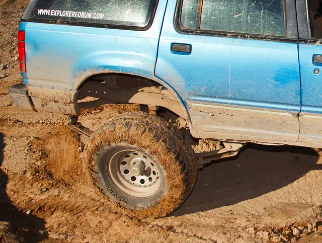

Personally, we don't run an overload spring anymore now that our X is more of a wheeling rig. The overload was limiting upward suspension movement. Of course, our springs will invert when we really flex the suspension which isn't exactly good for the springs.
truckhaven-rti-2011-1 by
maniak_az, on Flickr

It just occurred to me. . If you were to use a flat overload, and reinforce it so it wasn't just flat spring steel and weld that to the axle and make it part of the perch, I could see that helping more than just welding it flat on there.
something like this, but longer..
