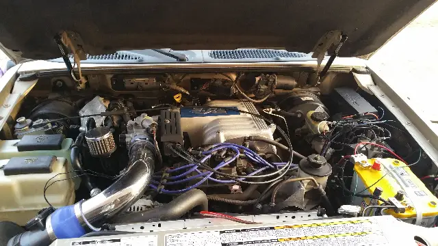

Got a little more work done on the truck. Temp has dropped a good deal but still made it outside for an hour or two while watching the kids play outside.
My new battery terminals came in and I swapped them out with the old crusty ones and they allow some more room for extra stuff be to wired up to the battery which gives me more room to wire in my electric PWM fan controller which I got hooked up.

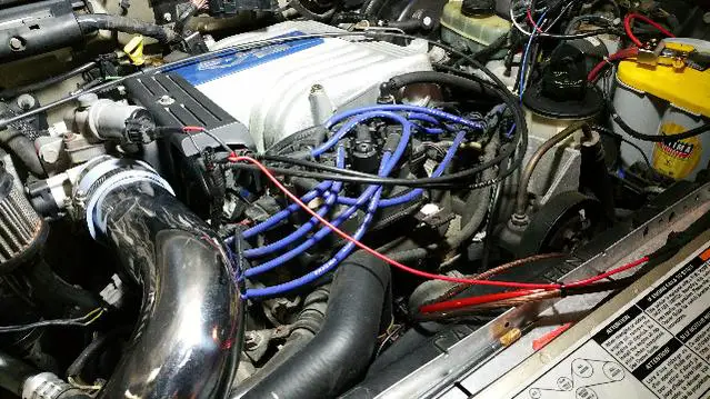

I was able to track down where the vac hose from the brake booster hooks up to the upper intake manifold and get it connected (at least it feels like I connected it all the way up as I had almost zero visibility to it lol). Also found the portion of connection that use to run to the old turbo system and yanked it all out and changed up the old T connection and hooked it all back up.
I did run into a couple "snags"... I found a couple plug connections mentioned earlier in the back part of the engine and where they plugged in at and plugged them in (yay) BUT... A random vac hose of some sort broke and the piece vanished and I'm not sure what purpose the hose served.
The vac hose is almost like a double hose connector thing located by the transmission dipstick by some of the old EGR stuff use to be and the green hose is the one that broke off... Circled in the picture. Looking over some old pictures it looks like this line is what hooked to the EGR valve on the top and I can simply seal it.

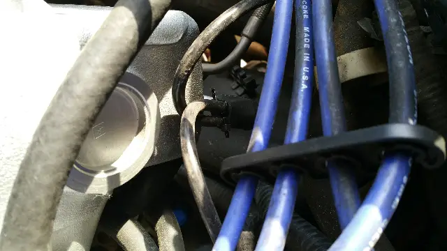

And the last thing I found still not connected and of which I cannot recall what it connects to is another vac line of some sort that is hooked up at the front of the upper intake manifold with a black boot connection and then runs on a long black vac tube and is taped off (something I did years ago while pulling things apart I'm sure). The photo shows the boot connection and then the other end (hooked it back around to get into the picture but the tube itself is a couple feet in length). Checking my shop books didn't prove very useful lol.
Photo is from looking from the front of the truck and that is the front right portion of the upper intake manifold.
