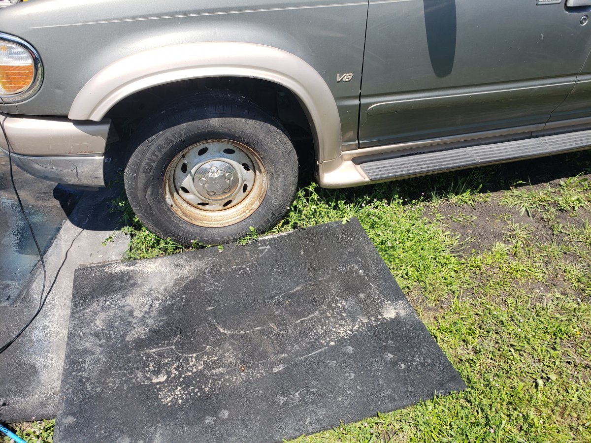

And horse mats aren't as good as a concrete pad, but they're way better than rolling in the mud:

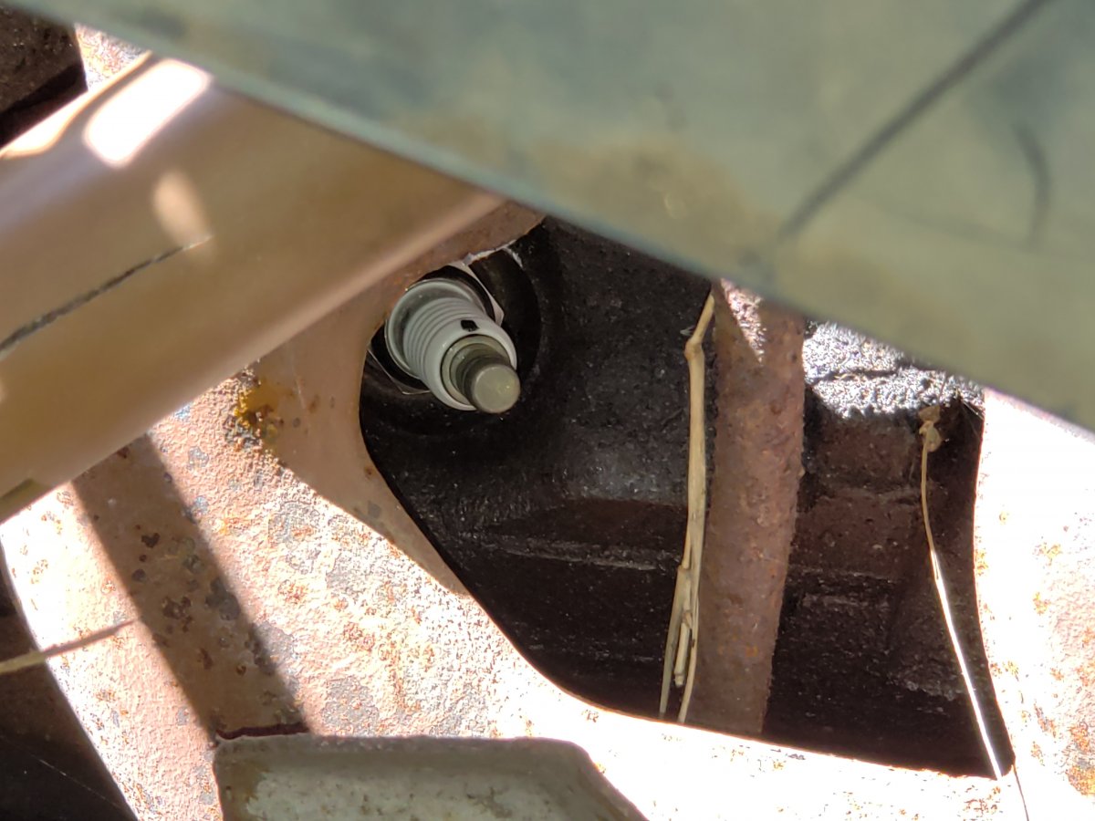

#7 spark plug is my favorite; easy to get to, and didn't need indexing.

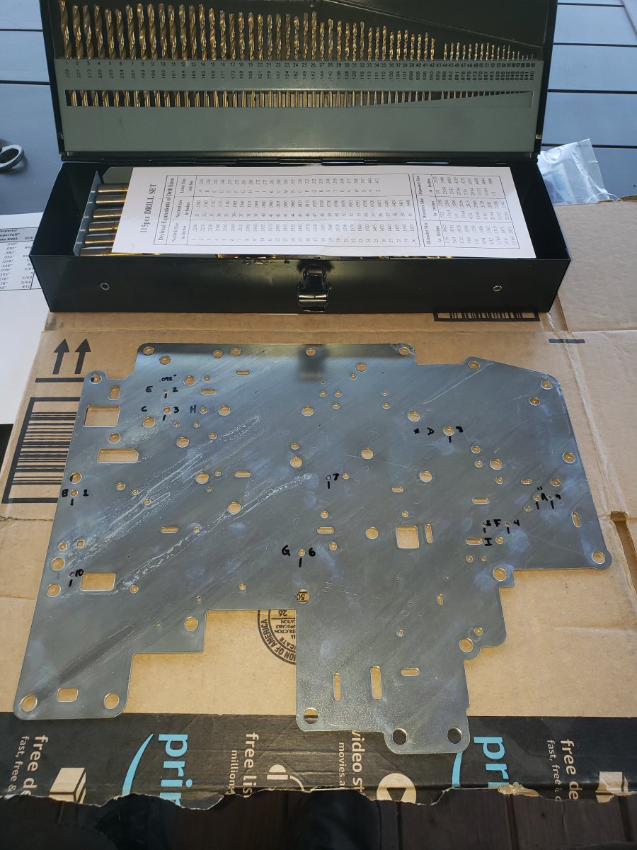

K092 "Super Tuff Plate" J-Mod'ed in a manner befitting a "Truck" transmission.
(Used Sonnax drilling guide, 2000 OEM hole sizes, Baumann/J-Mod recommendations)
Couple issues, documents say J-Mod hole #8 isn't used after 1996, but the K092 and the 2000 OEM Explorer plate HAVE that hole; this is the 3-4 upshift.
Factory is just under .235" (A drill), this was sized to .238" (B drill) as per docs based on the OEM size.
Also the 2000 OEM plate is missing holes #5, for the 2-3 shift, and holes #9, #11 for the 4-3 downshift.
Some of the 2000 OEM holes (#2, #3, #6, #8) were LARGER than the J-Mod recommended size for <300HP or <300HP w/gear change.
These got left alone (#3) or bumped up one # drill (#2, #6, #8).
The Superior "Super Tuff" K092 states it is "Late 2000+", but it doesn't have the bolt holes for the 2-3 Accumulator plate drilled.
The instructions mention "omitting" the 2-3 plate. I'm guessing the extra .030" of plate negates the .125" bolted stiffening plate?
Yikes.
The Baumann/US Shift drill sizes are for cars/early trucks (Pre-1996), NOT later trucks. Compare these to stock and 4 of the 7 holes in the 2000 OEM plate were larger than even the "Level 5" (Max) recommended sizes.
Based on this, I can't recommend the Baumann Kit with our valvebodies as the increased pressure spring and OEM sized holes may produce undesired "harshness".
Even the "Super Tuff" plate would have issues.
Baumann warns of this (in potentially missed notes), and request you contact them for recommendations.
If you DO use the Baumann Kit, please use an OEM car VB/Separator Plate, use in an early truck VB, or follow their specific guidance.
