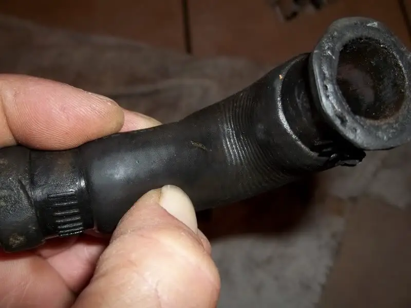

There is a little elbow bypass hose on the water pump. If you see a small puddle of coolant on top of the water pump in the lower intake area, this may be your leak.
