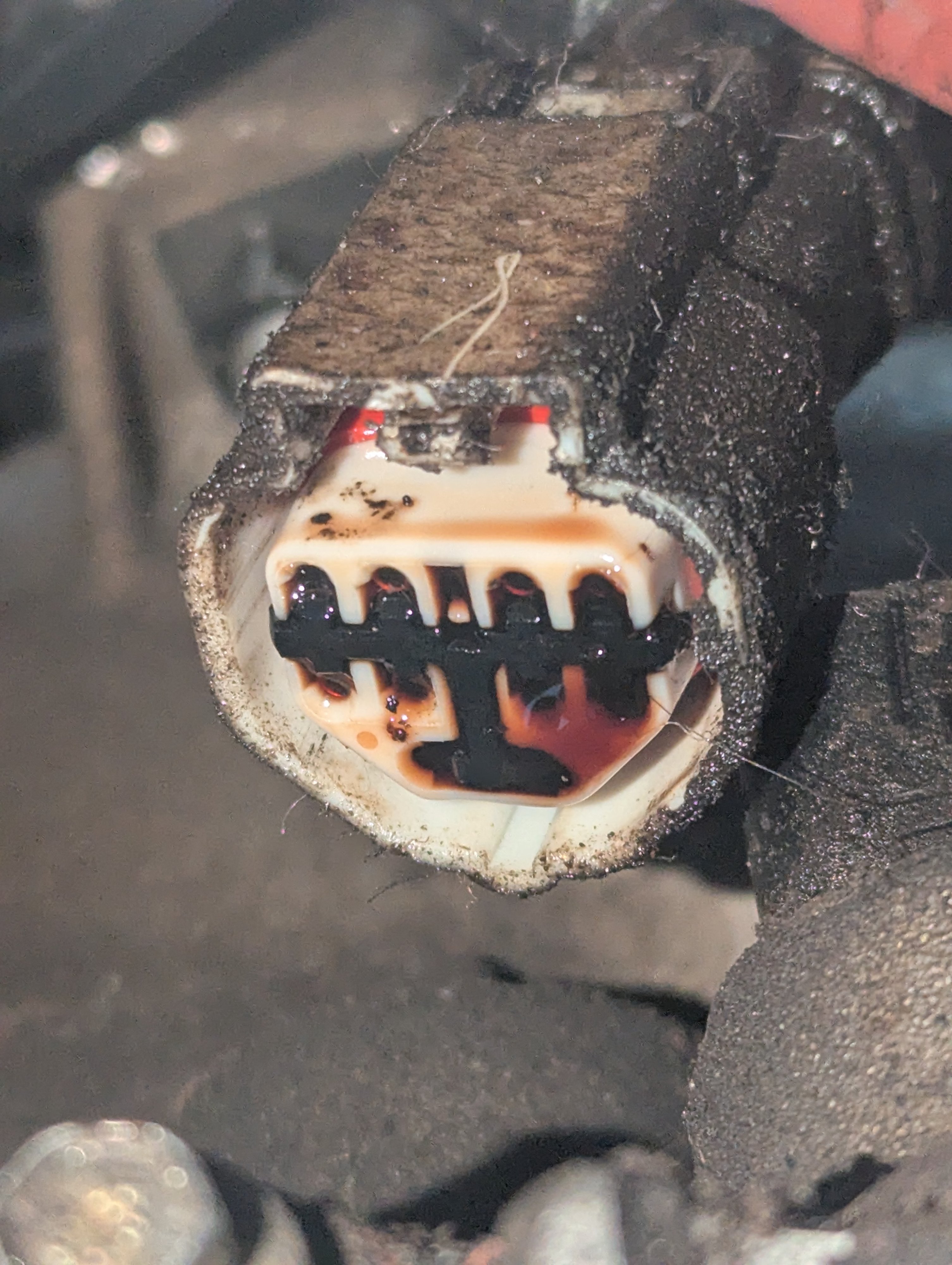

well I found the transmission and motor connector and it was exactly where you said it was right side passenger side rear right above pan yeah here's a picture of it let me ask you fortune? you think this might be my problem LOL?

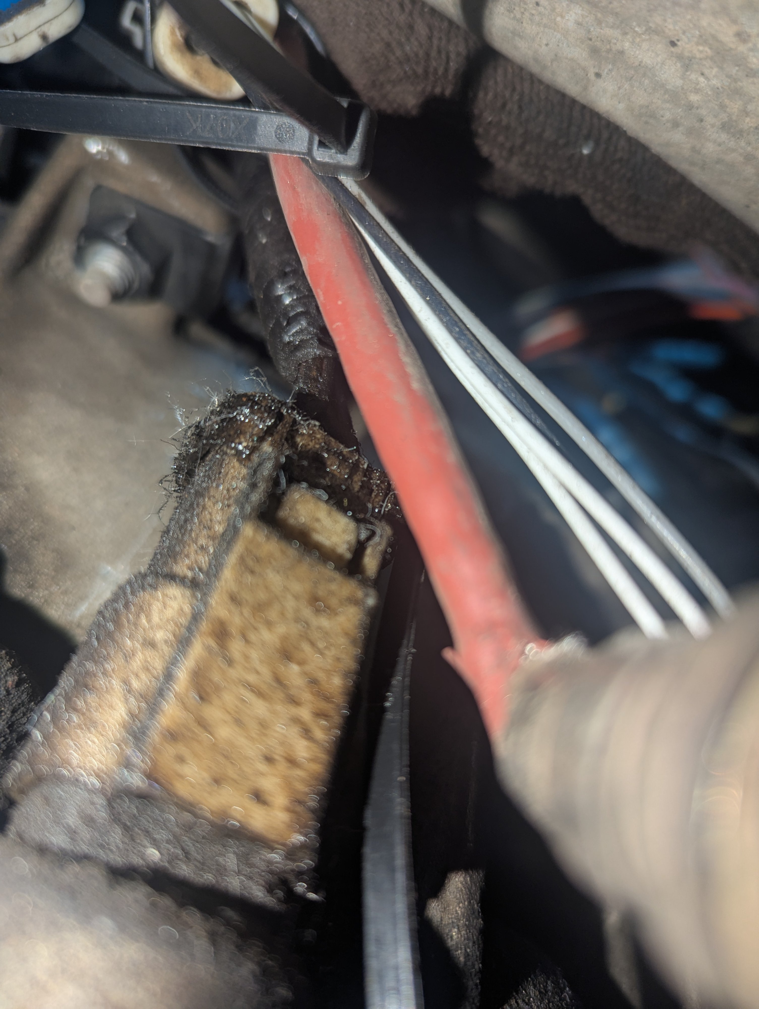

here's another picture of the inside of that connection there's enough oil in this mother ****er to service my truck I think **** me if this isn't my problem y if when I get this cleaned up and reconnected and my truck is still running like a POS that I'm ****ing giving up. I guarantee you I just found it
You guys aren't going to believe this **** I'm still trying to wrap my head around it......... I got that transmission connector all cleaned up looking like brand new dried out got it reconnected reconnected out of the other connectors that weren't connected + sat down in the driver seat knowing that I had just found the catalyst of my problems on my truck. I'm talking about 6 months ago no I'm sorry 9 months ago when my truck first started acting up again that connection was everything. so I knew that my truck my rig was going to be back on the road in a matter of seconds I turned it over and it started right up I went to give it some throttle and I noticed smoke coming from that access hole in the floorboard that I had made and then I saw what appeared to be a glowing light... .... Yeah, My truck was on fire. I got out looked at the engine bay and the flames were coming up in between the motor transmission firewall area lol, firewall, anyway I was hollering my roommate's name because she knew where a fire extinguisher was she was not answering or coming outside so I had the hose hooked up to my pressure washer I unscrewed the hose + turn the water on and by this time the flames were pretty much starting to engulf the fire protection layer of material underneath the hood so I started dousing my engine bay in that area with water + I was able to put the fire out... I thought...... well flames started up again + also the old piece of outdoor carpet that I had underneath the truck to lay on was on fire also. So I proceeded to spray some more water on my or in that area trying to keep my ****ing sanity and my wits about me but just not believing that this was happening right now. I I just found out the problem with my rig and this is happening. so with my truck smoking + water dripping off everywhere I just sat down and shook my head in disbelief. I was pretty much mindless for a good 10-15 minutes and then I started thinking or wondering what caused this fire and I said to myself I caused this fire I caused this fire because of all the ****ing bullshit that I did to fix the problem that wasn't the problem and in the process I cut some corners I settled one of the things that I settled or the corner that I cut was when I replaced that section of a fuel hose with rubber fuel hose instead of that hard line was that the reason for the fire I don't think so. because I got underneath the truck after a while + pretty much saw the start of it and it was at the first ho2 sensor. that's when it hit me those are heated circuits those motherfuckers haven't been working at all until I cleaned out and fixed that connection then when I started my truck it was working heating up + he did something up it shouldn't have and who knows what that could have been some residual fuel residual ****ing starting fluid I don't know some bullshit ****ing old plastic those flames started immediately I know that......... So here's what I'm going to do, I am yanking every wire from the mass air Sensor to the c116 connection that whole harness system is coming out and I'm going to go down to U-Pull-It and I'm going to yank one out of a rig down there and I'm going to replace it with that I'm going to get my EGR hooked up correctly because I cut that down tube out and blocked off the the two open ends one at the manifold and one at the EGR bottom because I couldn't find that down tube I am going to get a correct fuel rail one that's not welded keep in mind that weld is still holding and it's not the reason for the fire I'm going to get new injectors I probably don't need them but I'm going to get new ones anyway and I'm going to install everything myself because believe me, I could do it blindfolded now......... I hope you enjoyed my story + I will keep you guys up to snuff on what's going on and thanks again. stick man out.

Some trans fluid in that white plug is normal but yours looks excessive
