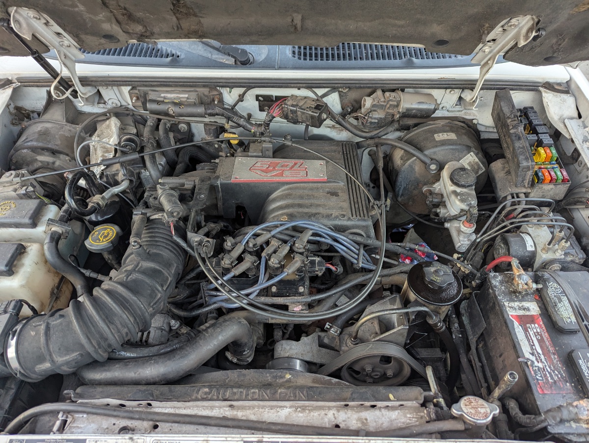

Pics thus far

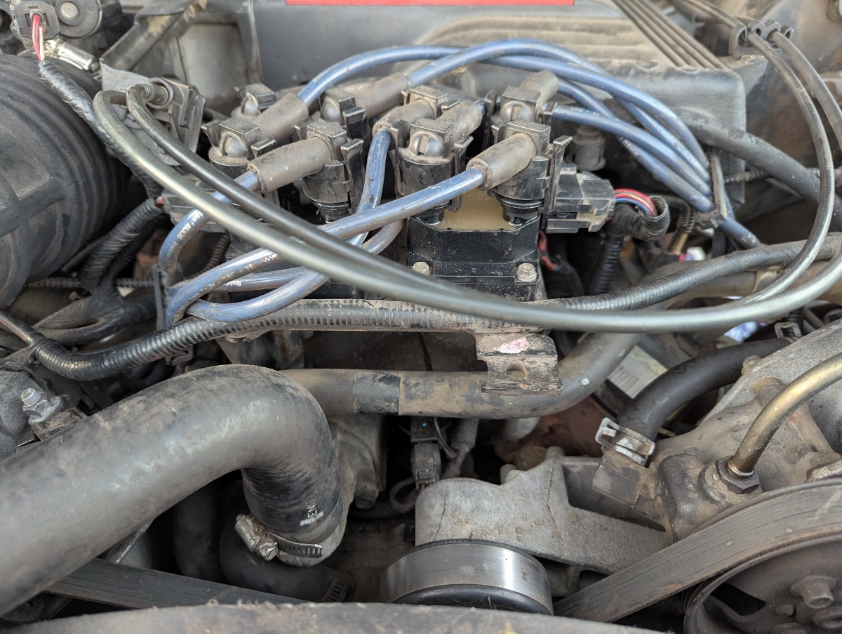

Firing order looks good from what I can see

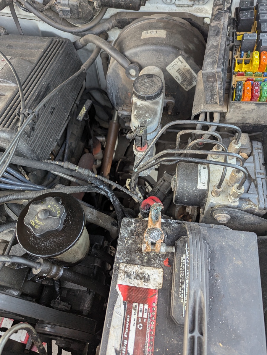

All fuses diode and relays in place
Positive battery terminal looks okay but not great, I would like to see cleaner copper and less exposed, less fray. Some tape would really help. Make sure it is All snug
I can see the recall for cruise control brake switch has never been installed. Need to get one of those installed.. until then unplug the wiring connector at the cruise control switch on the end of the brake master cylinder
That sucker can actually burn up your truck or worse

Firing order looks to be correct from what I can see on coil pack
Might want to remove coil pack tower and remove the camshaft position sensor, two 5.5mm screws, then crank the engine and see if the cam sensor is turning

Battery voltage is very low on the gauge
Look at the positive cable in the picture above, looks like 2 strands left.
okay it's not two strands left guys okay it's not the greatest I understand that but it's well accepting that current. I can appreciate the perfectionist that you guys have become I really can but you knew there was going to be a butt, I roll that way also in my line of work but when it comes to my rigs it's whatever ****ing works + it's not working the battery not being at full volts is not going to cause no spark at the coil at pax you and I both know this so instead of knocking my **** why don't you reach down in deep in your knowledge vault on Ford explorers preferably the 302 V8 motor and tell me what is is wrong. I'm not trying to come across as an asshole I'm just spent, frustrated, and almost completely ready to stick a stick of dynamite in this mother ****er and just watch it ****ing blow up so my apologies if my attitude doesn't measure up to yours. I am right now as we speak double-checking the wires and the wiring from my crankshaft sensor or I'm sorry, I don't know I said it right, crankshaft sensor. you proud of me, Fortune? I'm doing this because my AI chat gpt told me to. because I have eliminated everything else I don't have a broken timing chain it's not fuel related all the grounds are in contact I will add that I forgot to mention well that my tachometer the RPM gauge has not always worked in fact it has not worked more than it has. saying that is intermittent would be a complete understatement so that's why I'm rechecking the wiring on crankshaft sensor. I also will tell you that, I didn't think it was a big deal, but I didn't put back on the crankshaft sensor the metal jacket or cover protector whatever that thing is I didn't put that back on when I replaced the crankshaft sensor. now you're probably going to tell me that I'm a ****ing idiot and that metal jacket protector thingy is supposed to be on to make that read the crankshaft. well I don't know better so if you do tell me that I guess I have to eat it, then. well just to just say I'm putting it back on. it's going to take me four ****ing hours to undo two bolts and to put two bolts back on while holding that protective thingama jig, stupid ****ing metal thing in the right spot so I can get those ****ing bolts threaded again I can't get my hand down there......it's a ************. anyway I'll keep you guys abreast of the sitch
I've had my ass handed to me more than once cause of something as simple as a bad positive battery cable causing a no start. Not a perfectionist thing, and sure it may not be the root cause of your issue today, but eventually it will rise to the top of the list of things needing immediate attention.
