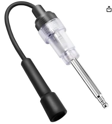

You would need to have a helper turn the engine over (crank it at the key) for you to be able to see if the light is flashing on the inline spark plug tester. (pictured below).

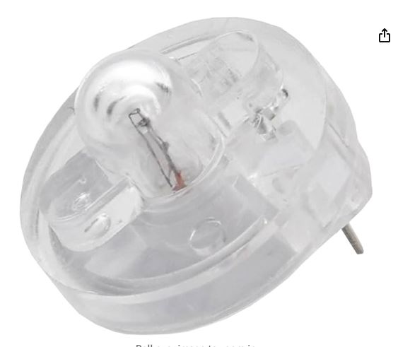

Then attach a noid light tester to an accessible fuel injector connector. (pictured below). Again, have someone crank it over.
If the lights flash during these two tests, then those two things are working. Guys, correct me if I'm wrong but you need about 40 to 42
pounds of fuel pressure at the rail.
Do these 3 tests and get back to us.
