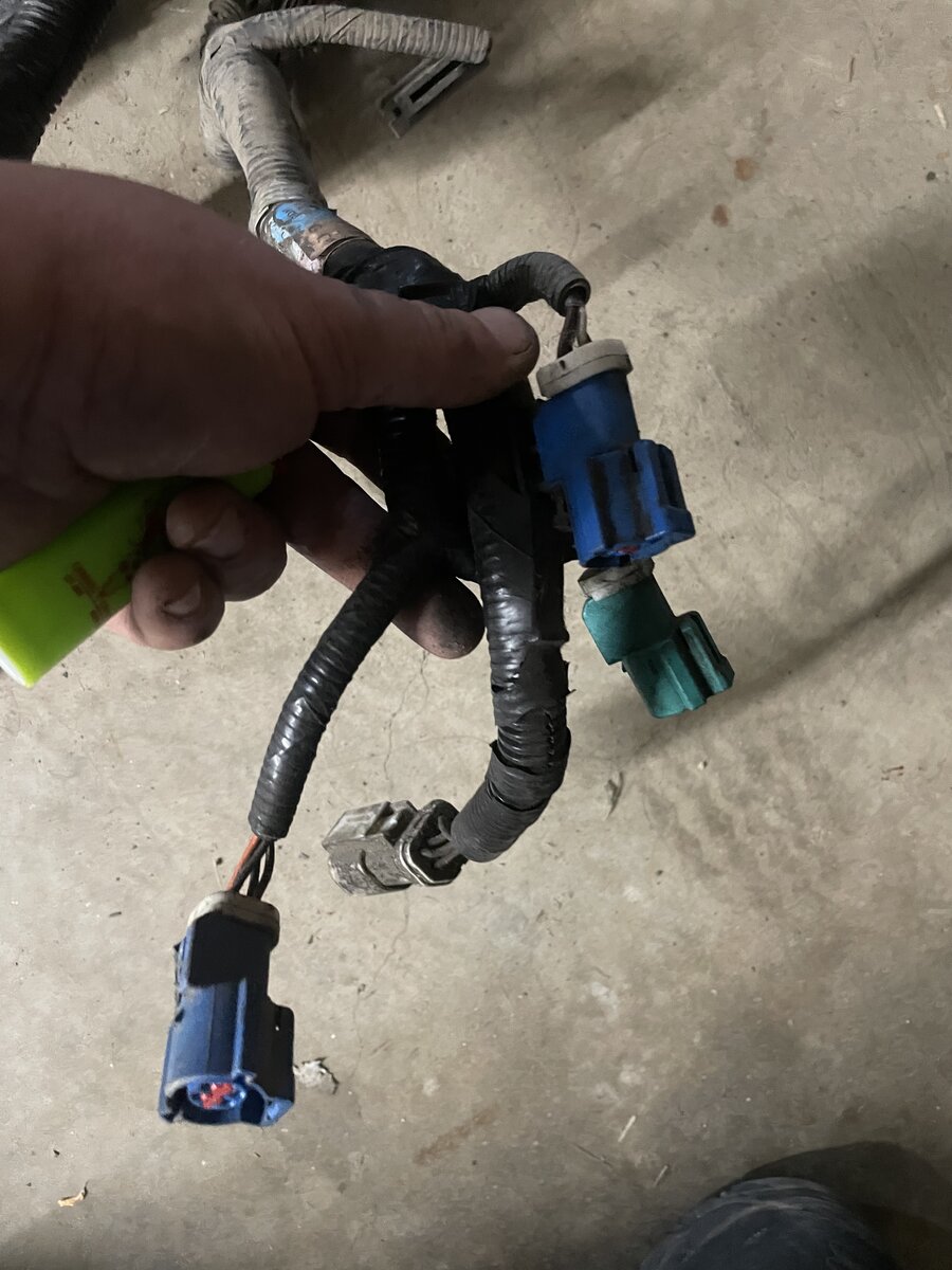

I just happen to have a 97 5.0 trans harness in the shop
Here we can see indeed the two blue connectors are for downstream sensors the single green is for pass upstream sensor
