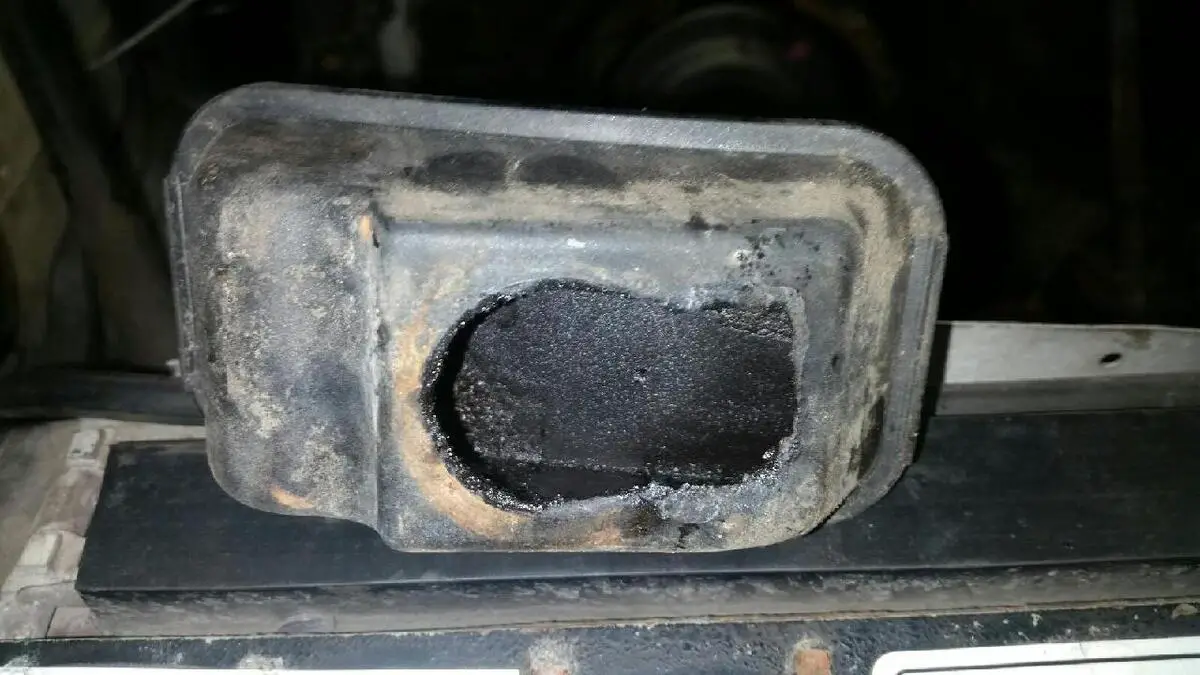

Does anyone know what this part is? I'm trying to figure out what it is so I know how much it might cost to replace it. Also, does anyone know why it would have a hole in it? Is this common?
http://imgur.com/gallery/1Z430r9
http://imgur.com/EQzhLcq
^ Where on or near the engine is that from? Looks like it got cooked...
I don't know, the mechanic just sent me a picture of it. I found out it's a crankcase vent oil separator assembly and it goes somewhere on the bottom of the engine, like Ford part number F77Z-6A785-AB.
