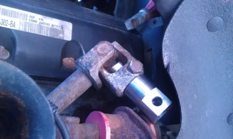

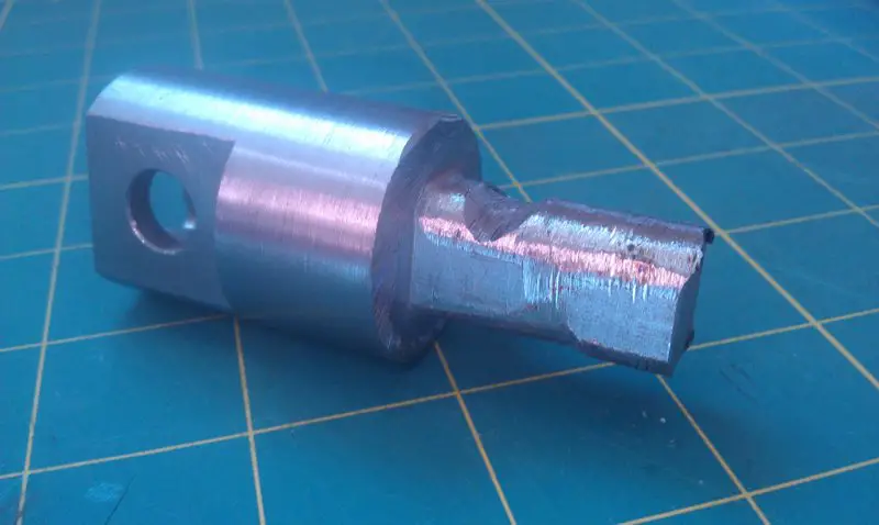

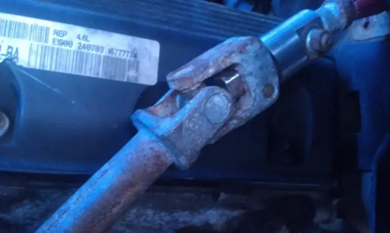

Sorry for bumping this - but I want to post the fab files I drafted up for the steering extension required on 4.6L V8 3rd gen explorers. I fabbed mine out of solid 1-1/8" aluminum stock.
I made some small adjustments on the fly grinding away bits of material to get a snug fit. Photos attached. This was done sometime circa 2012(?) and still running strong.
