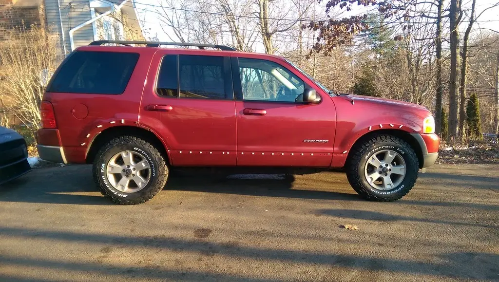

I have been considering a larger tires and a moderate lift for a long time. This is my second 3rd gen Ex but I never got around to doing anything to my first one. I got started right away this time. The body molding has been removed to have bedliner applied and to cleanup body rust.
The tires needed to be replaced so I went for 245/75R17 (31.5") BFG All-Terrain T/A KO2s.
These tires only rub the slightest bit when I'm pulling on the steering wheel at full lock. They give the entire truck a solid 1" - 1.25" lift when measured from the ground to center bottom of fender.
The 0.5" factory rake never bothered me before but it is made very noticeable by the way the tires fill up the fenders now.
I have ordered a custom spacer lift (F1.75,R1.5) from BTF which I'm calling the 2.5inch semi-levelling lift. I haven't seen one of the same size on here yet but I think it will suit my tastes. I will post up some pics once installed.
