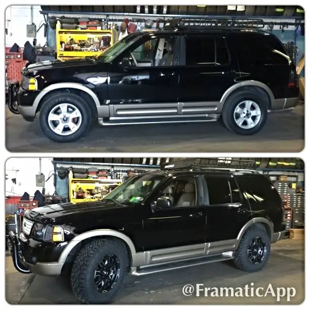

Heres the before and after pic of Mr. Eddie :D
