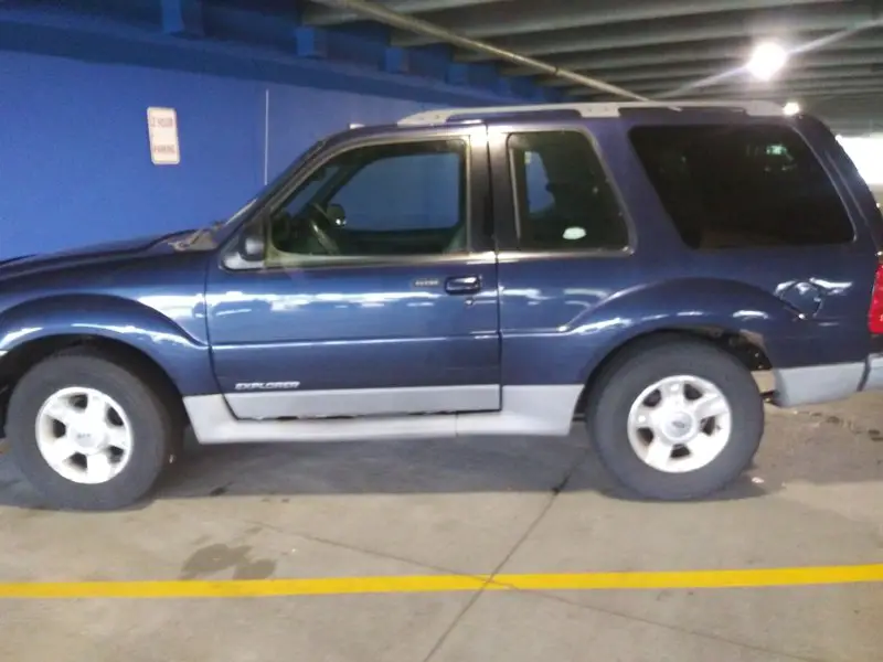

I cant not find rocker panels for the out side because mine have rusted out and the bottom plastic trim piece is barley being held up. I have a 2002 ford explorer sport 2 door. Any help should I just buy slip ons and cut them to fit since it will be hidden anyway. Has anyone worked on this car specific before and does the 4 door rockers line up with the factory lines on the 2 door.
How about a wrecking yard -- then you need someone to cut and weld and paint after installation.
I found a site that has slip ons and I dont got to cut since its covered by the trim at the bottom so I think I got it figured out.
I had another member ask about rocker panels for the 2002 Sport. How did the slip ons work for you? Do you have a link to the vendor?
