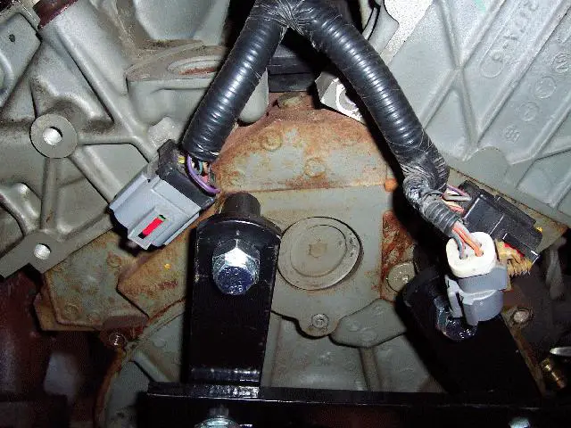

I have 2002 Explorer, 4x4, 4.0 V-6, Eddie Bauer edition with about 174,000 miles on it. I had my transmission rebuilt about a year ago and it shifts perfectly. Recently I have had the OD flash with codes P0755 and P0760 come up pointing to solenoid B & C so I replaced the solenoid block and the codes still come up the OD light flashing. The trans shop said the solenoid is working perfectly and so is the transmission. They did an ohm check on all lines which from the PCM which checked out fine, so they think it's the PCM.
Question: I've looked into replacing a PCM and it does not seem very complicated, but some of what I have read says that the Ford dealer has reprogram the keys, etc. Is that true or can I replace it myself and assume it's plug and play.
